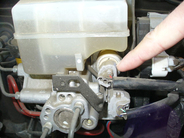

I have spent a couple hours researching this on several forums. What I could surmise is that the best bet is to disconnect the pressure sensor. However, I'm having trouble locating it. I have seen pictures that resemble my engine but never exactly. So I'm attaching a photo and in the photo I'm pointing to what I believe is the pressure sensor. Please help, I don't want to screw anything up.

bstevo2 - the plug you are pointing to at the start of your post is the one you want, not the lower 2 wire plug
No, No. It is the two wire one.

I have looked into this mod heavily, and havent quite pulled the trigger yet. If i have to restart the car its not really worth it to me... i might as well pop the hood disconect it, have my fun, and then reconect it. But i have pulled it many times and i am certain (at least on the 05s) it is the 2 wired one.
HAfrica13 - I'm going to have to disagree with you, I just tired this as I have done before. Removing the 3 wire plug - warning lights to come on, removing the 2 wire plug - no warning lights. In the picture of the FJ you can see there is only 1 plug coming off the front while on the 4Runner there is 2. bstevo2 you can check out this past post where gonzo installed a switch cut into the red wire. Go about 1/4 of the way down the page.

Hmm... i just went ot to check again... and i only have the one plug coming off the front of it with two wires (like the FJ). I guess they must have switched things up on the 05. So we just have different systems. Sorry about the confusion, since yours is an 04, pull the three wired plug.
I just went out and checked my 06 Sport V8.
I have 2 wire coming out of the plug. One is green and one is white with a black stripe.
