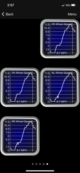

7. Here's where it gets better - got an OBDLink MX+ OBD2 Bluetooth Scanner for $100. Pulled codes and got
C0215 Rear speed sensor LH circuit
C1223 ABS control system malfunction
Tried clearing codes, didn't work.
8. Figured maybe this means left rear ABS sensor, so replaced that. Roughly $30 for two sensors as I remember. That didn't work, so replaced right rear as well since drive through chain said that was the problem initially. Didn't work.
9. Used the "create dashboard" tool on the OBDLink app. Could clearly see that there was no left rear wheel speed signal coming through. Since we already replaced the sensor, ordered a new ABS wiring harness for about $100 and replaced.
And... lights have been off for days. Not counting the OBDLink, spent $163 and some hours instead of $1000. (Actually, probably would have been more since they diagnosed the wrong problem in the first place.) I'll use the OBDLink again, so I'm happy to have spent that money. I'll attach a screen shot of the dashboard showing all four wheels getting a signal now that it's fixed.
Thanks to everyone who posted in threads about ways to solve this problem!
