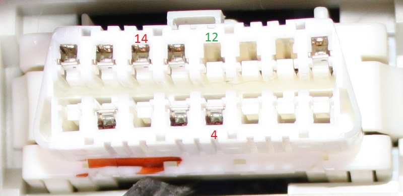

Here is the ZPC method I use.
I use 2, 12" 16awg wire, with a knot on the side I plug in, 3" up. Ends stripped.
Speaker wire was mentioned in that link.
On my 2004 SR5 V6 it is TS=14 and CG=4
Parked flat and level, steering wheel straight.

Look at your pin-out at the plug to see what to use.
