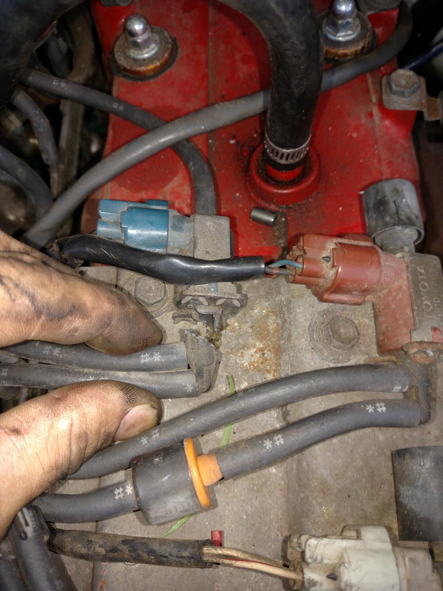

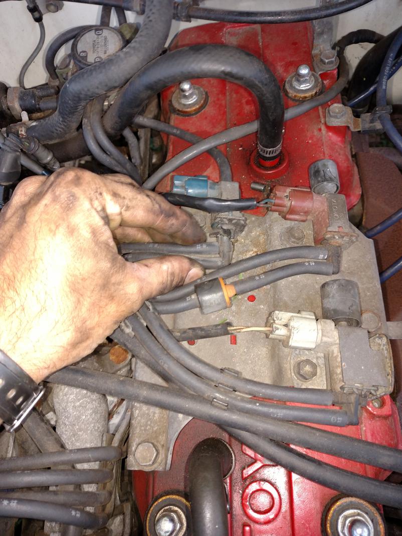

What did i break now?
Is this the vsv? 1989 4runner 4cyl 4x4
Is it safe to start up? can i drive it like this to work tommorrow? (my only car) if anyone knows the specific name or part # that would help a lot....
Those actually look like the 4wd vacuum switches I have on my 97... But I'm unaware if there is any similar thing on the 89...
I would test out your 4wd and see if you can both engage and disengage 4wd..
