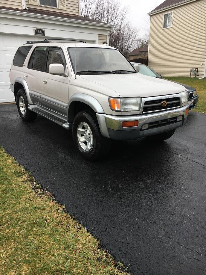

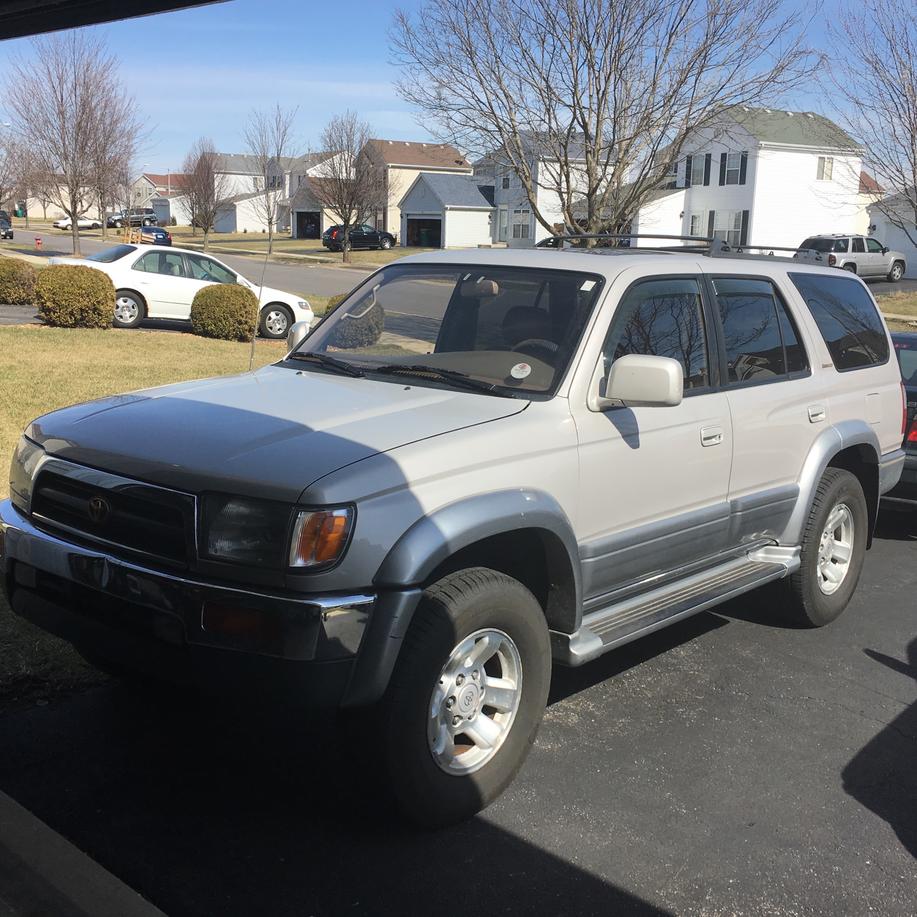

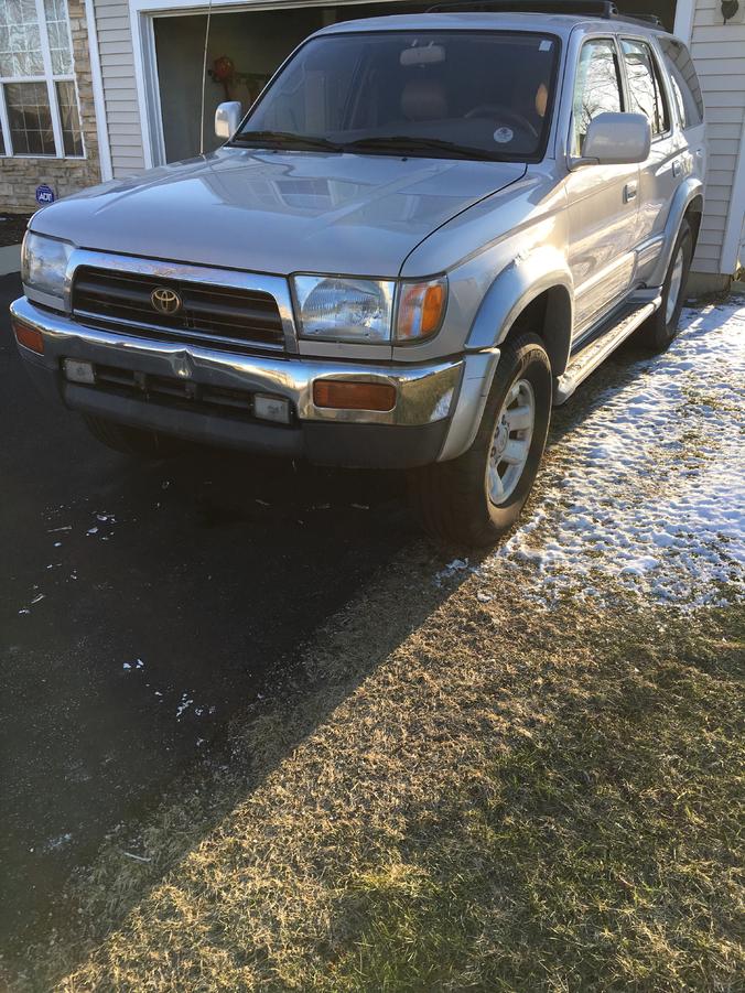

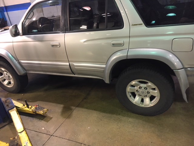

Some pics of the truck...

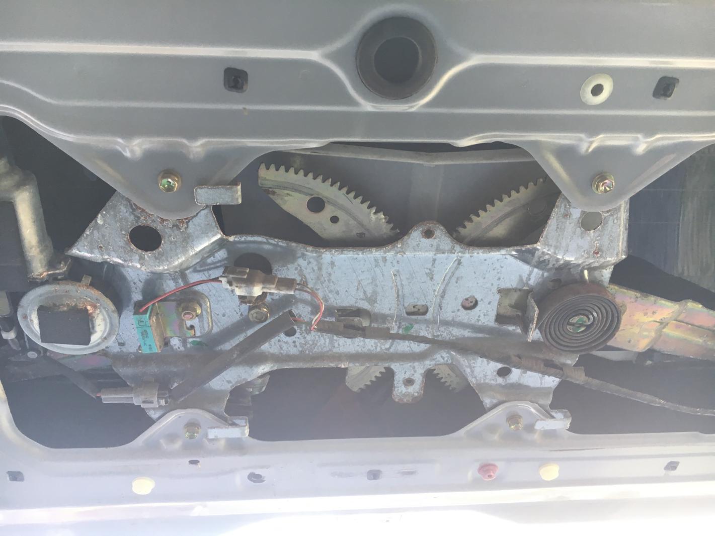

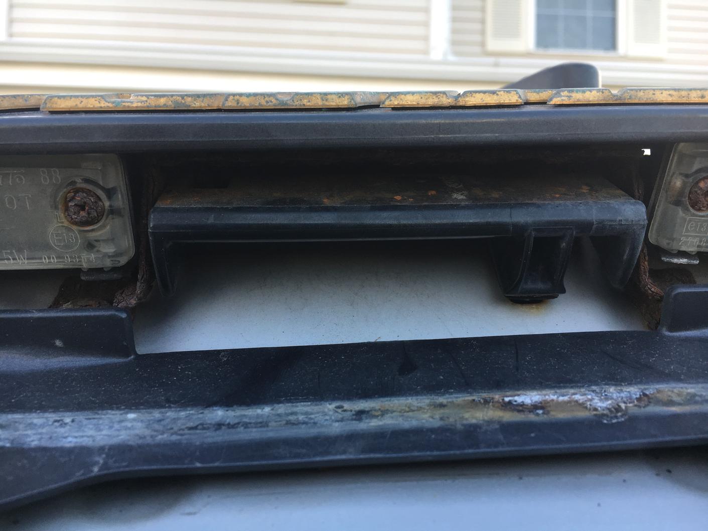

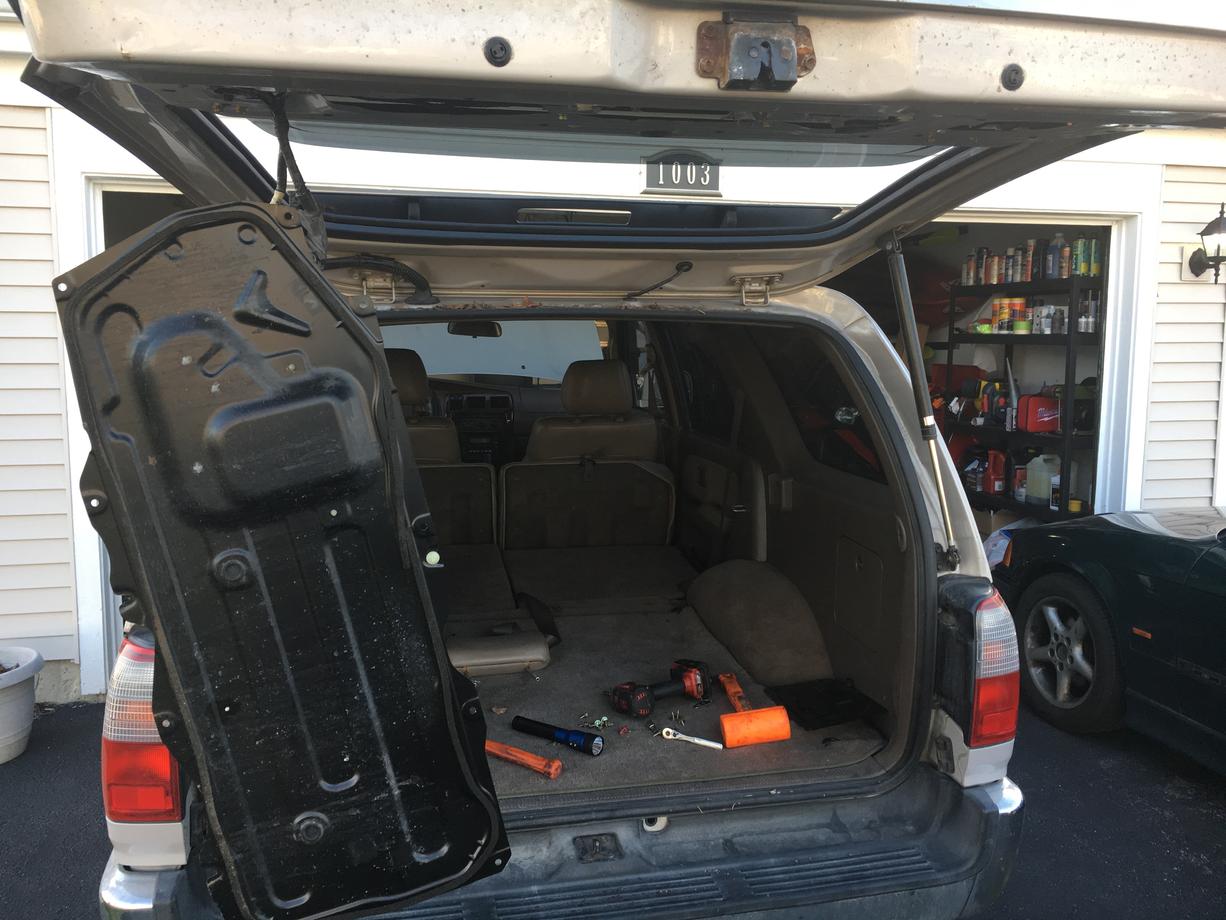

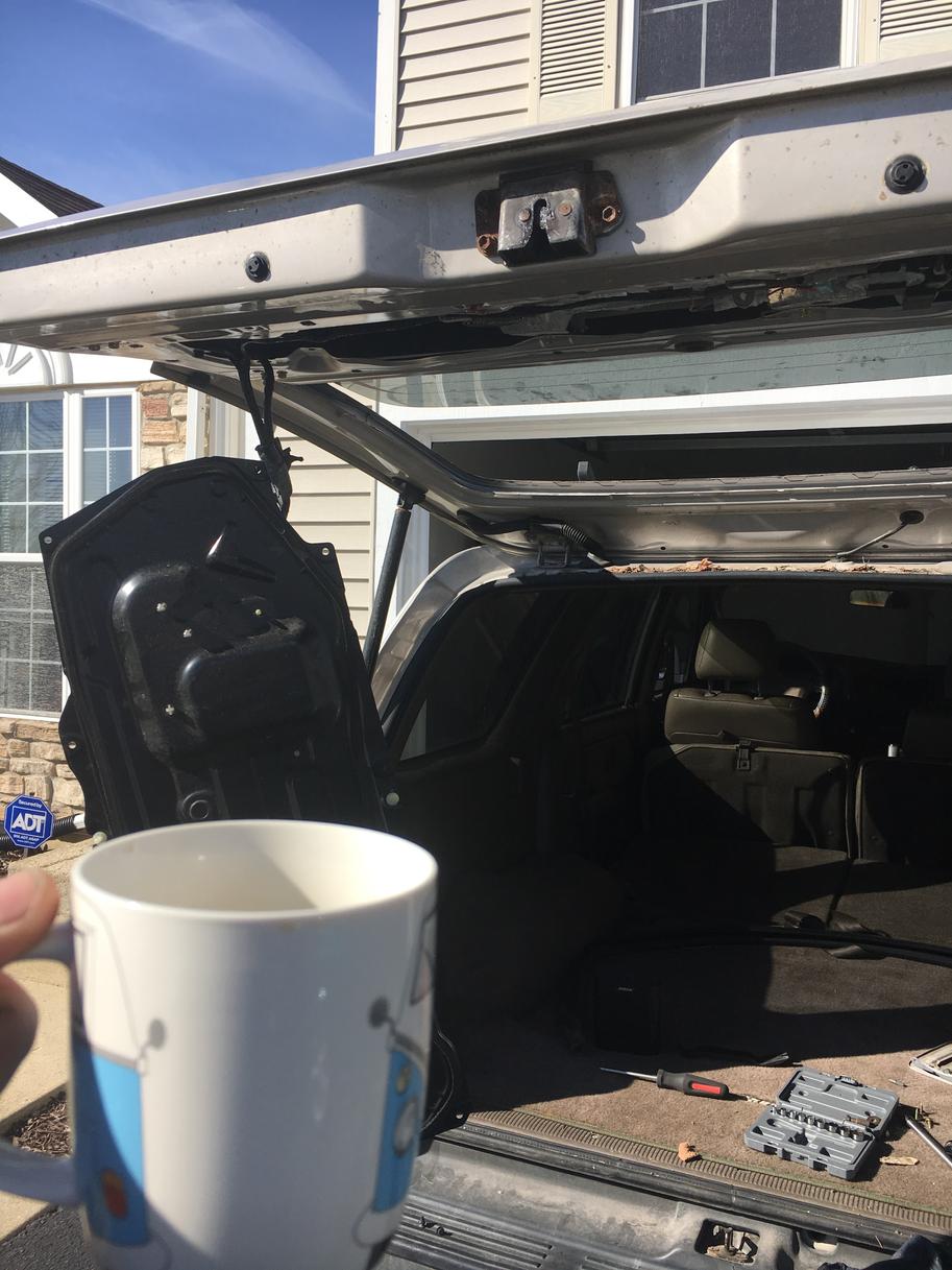

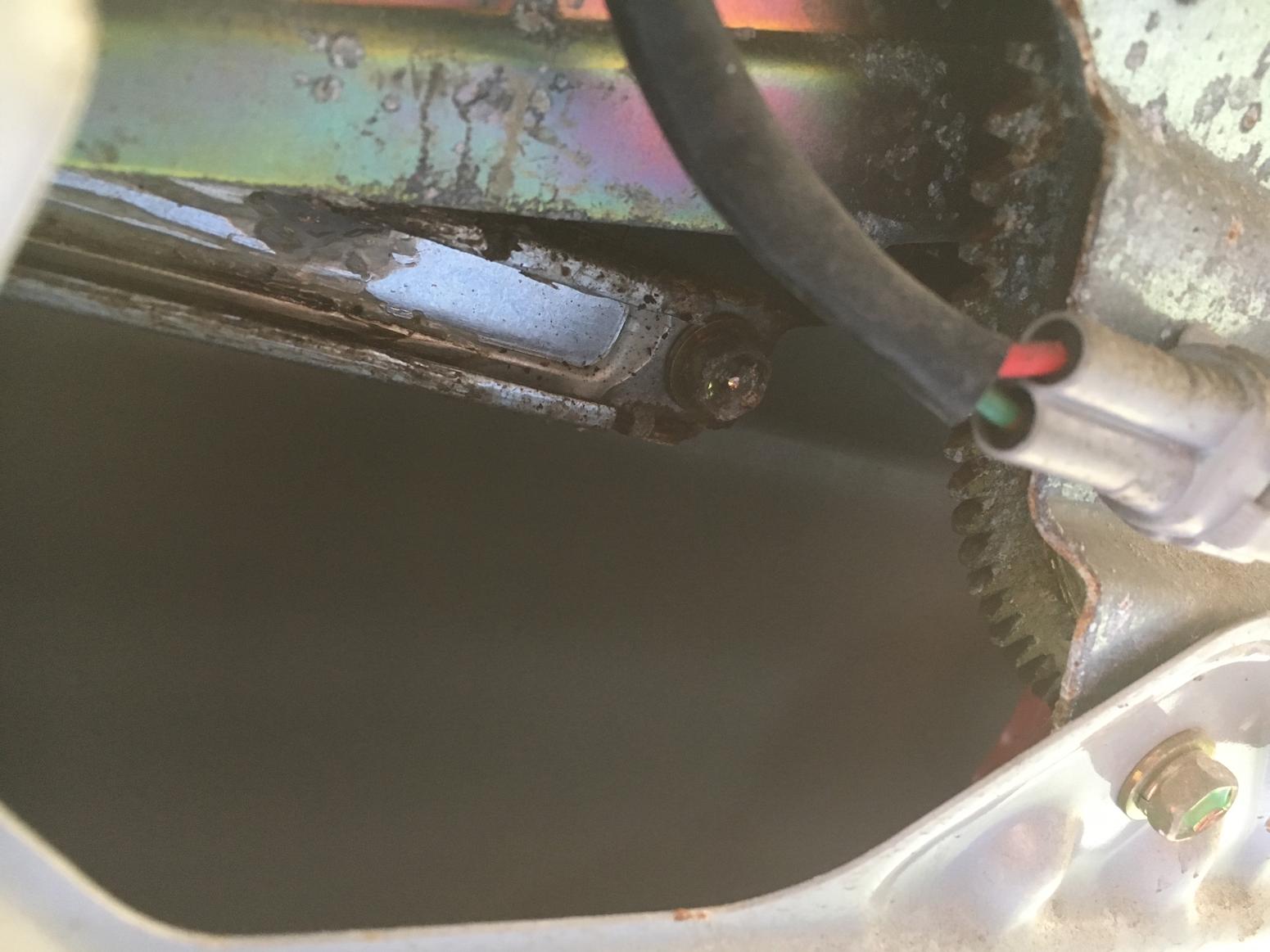

Truck was not without it's problems, hence the low price I was able to negotiate. The power steering lines had rusted out, and leaked power steering fluid. Pretty much all the sway bar bushings, and link bushings, as well as the rack bushings were blown apart. On top of those issues, the truck was missing the fuel door. The rear hatch had a massive dent on the left side which was preventing the window from rolling down, and the rear hatch handle had completely rusted out preventing me from even opening the hatch.

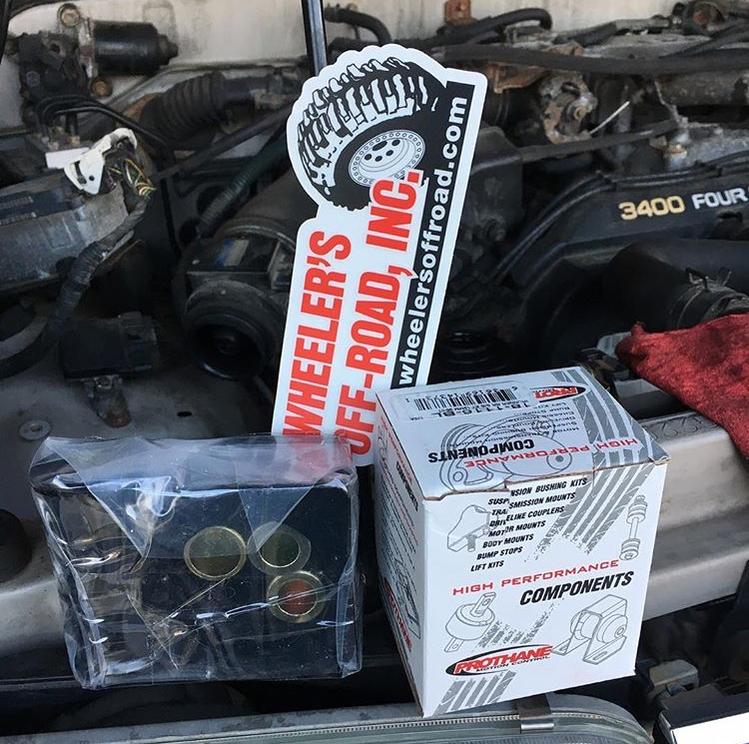

I ordered up poly bushing kits from wheelers for the rack, and front and rear sway bars/links. I also ordered the power steering lines from rock auto, and new sway links for the front. I ordered a new hatch handle/bracket from Toyota, and picked it up the next day. That night, and into the next morning I got to work replacing the rear hatch handle/bracket assembly and knocked out the dents on the hatch, as well as lubricated the hatch window regulator, cleaned up, and anti-seized all the bolts I removed in the hatch. It will have to come apart again at a later date to replace the rear license plate trim that is busted, and replace both the dim/oxidized plate lamp assemblies, but for now I was happy the window now works perfect, and the hatch opens/closes perfectly.

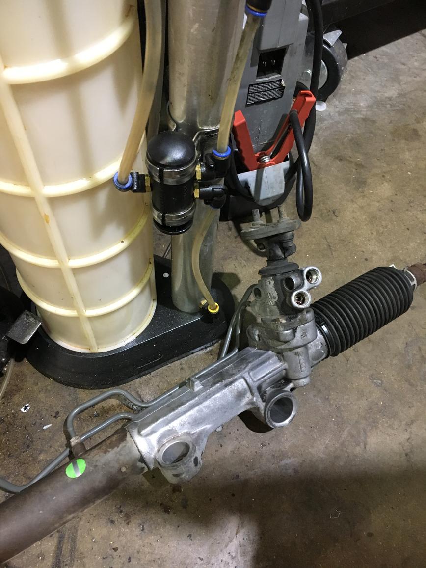

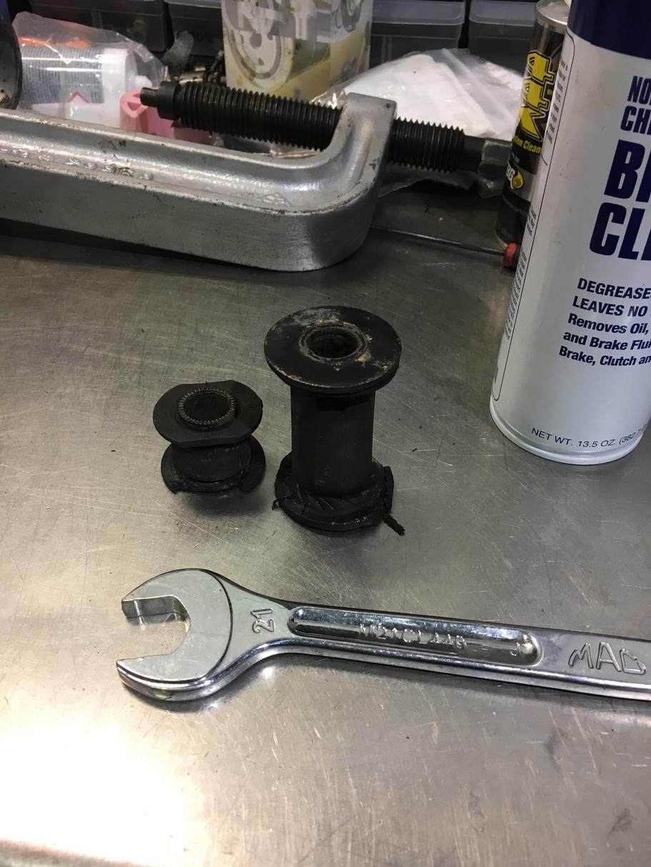

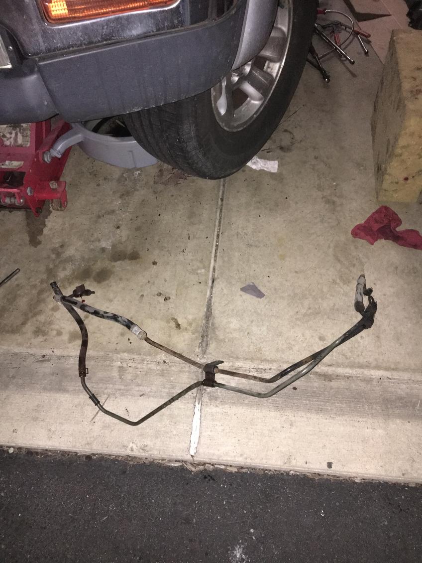

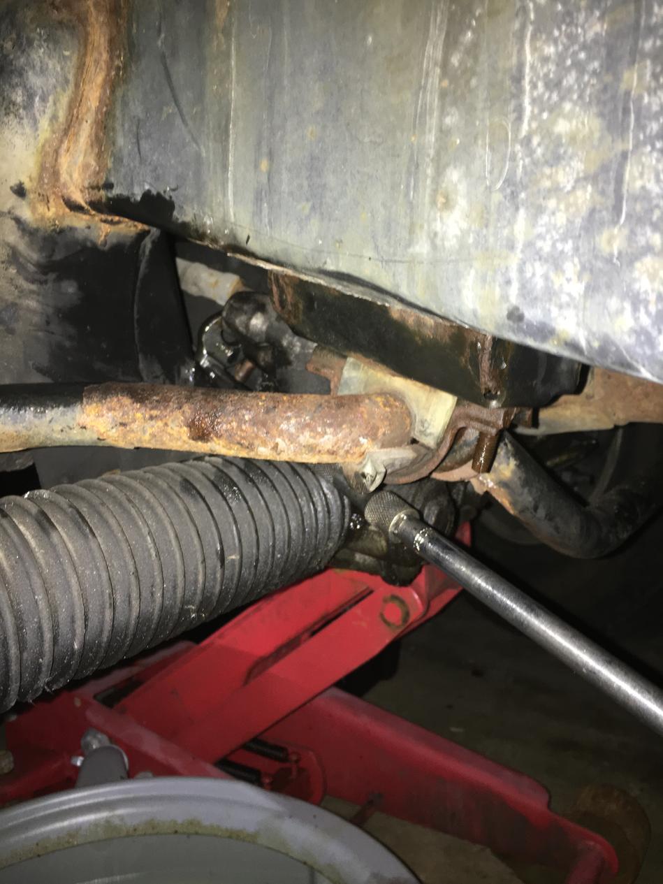

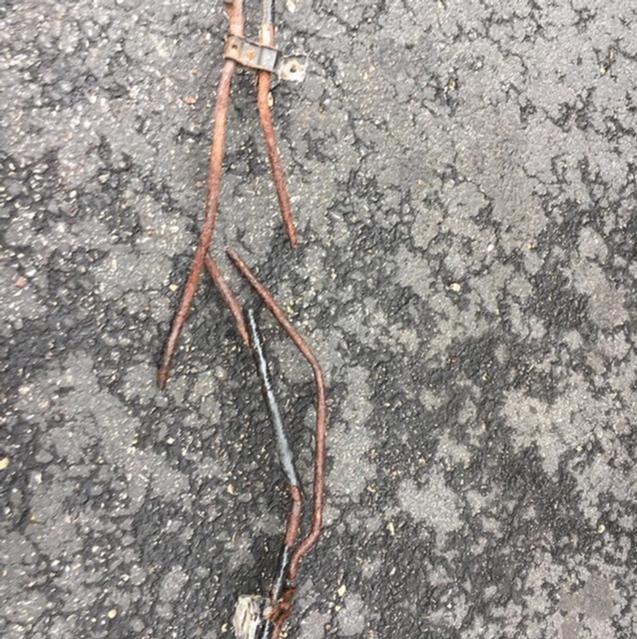

Next on the list was the rotted out power steering lines. I managed to pull them out of the truck without loosening the steering rack which turned out to be a waste of time when I noticed how truly worn the rack bushings were. I ordered a poly kit from wheelers, and removed the sway bar, the links, the rack, and the power steering hoses. The rack was pretty nasty from the drivers side valve cover leaking so I decided to take it to work to clean it up, and install the new bushings.

I took care of the rack bushings with Poly ones from wheelers, and also installed new front sway links, and replaced those bushings with poly as well. During that install I bumped the rotted out rear heater core lines with my ratchet handle, and they crumbled.... better in my garage then on the road. So I ordered up a set of those lines from rock auto, installed them, and flushed the cooling system out before filling it with Toyota coolant. I installed the new rack lines, flushed the power steering, and filled that as well.

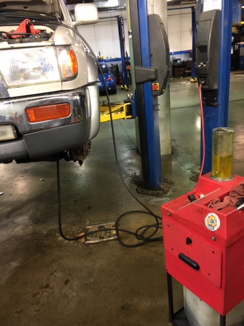

The 4runner was finally ready to take to the lift at work.

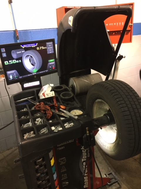

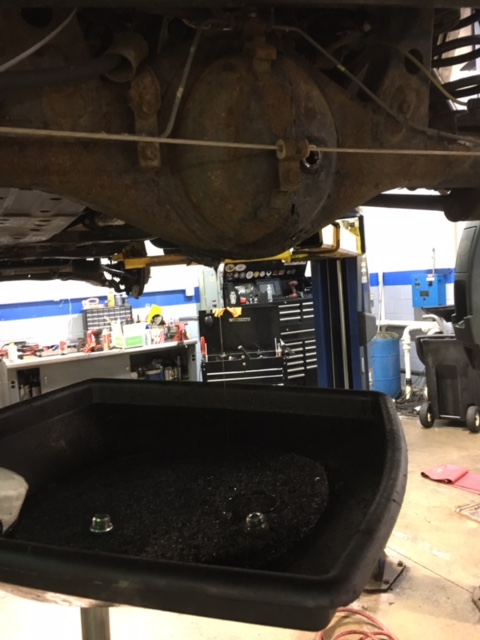

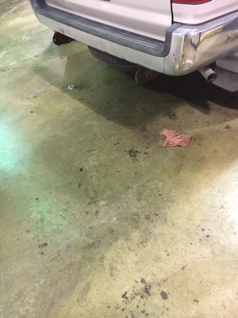

Once at work, I changed the oil with factory filter, and synthetic, as well as changing the fluid on both diffs, the transfer case, and transmission. I also did a brake fluid flush to get the old nasty brake fluid out. I removed the rusty rear hitch, and brackets ( which was a giant pain in the ass) so I can coat the frame with rest prevention inside, and out. I also replaced the spark plugs with factory Toyota plugs, and replaced the air filter as well. While I had the wheels off I road force balanced the tires, and gave all the suspension components that are worn out a good soaking in PB Blaster ( I've been doing this periodically so when it comes time hopefully things will come apart a little easier. The last little bit of maintenance I did was grease all the driveline u-joints, and slip joints.

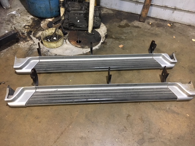

Tore the running boards off the side of the rig today. Looks a million times better I think. Gave the truck a good wash to get the salt off the body, and frame. Used WorkHorse brand cleaner on the dirty door cards to clean them up, and it came out great. No pics of the cleaning yet because I need to do it a couple more times, but that stuff works, I highly recommend it. Also if anyone needs running boards for a Limited, and can pick up in my area PM me. I'll let em go for a good six pack of craft beer. Great condition!!
