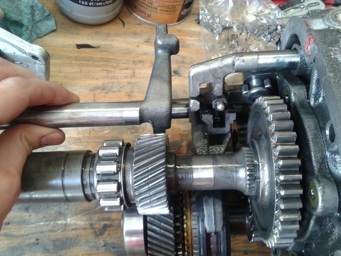

After replacing the input bearing, seals, and gaskets, I reassembled everything but I don't seem to have something lined up properly. I tried rowing through the gears before I threw it back in the truck and no joy. I can't remember if I had it in gear or neutral when I took it apart. I'm assuming it has to do with the gears and gear selector shaft alignment. Yes, I've searched.

I'm not sure what style you have of the W 56 some have an inspection port Just open the top inspection port line it up and you're done
You didn't mention whether you have a tsrm for the w series transmission or not, but the assembly is relatively detailed in a few of the tsrms I have.
If you need it, I can send you the manual trans section from one of the many I have here.
Figured it out. The lower shift fork notch is reverse and it has gotten pushed forward. Once I moved it in line with the other fork it all worked perfectly. Transmission is back in and working just fine.
