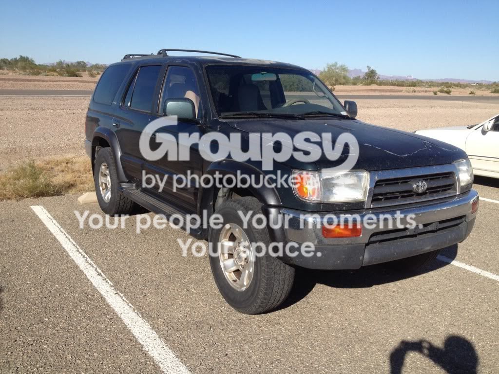

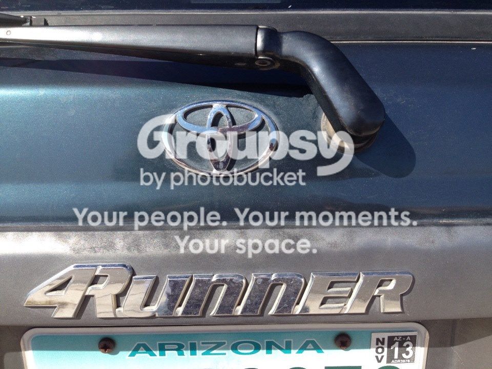

I am starting my build with a '98 4runner that came as dowry, with 160,000 miles on it. She is a Canadian transplant, my wife is from the Northwest, I found that out because of the "Windshield Wiper Fluid" light.
This is her at the start, the sun destroyed the paint in the past 8 months.

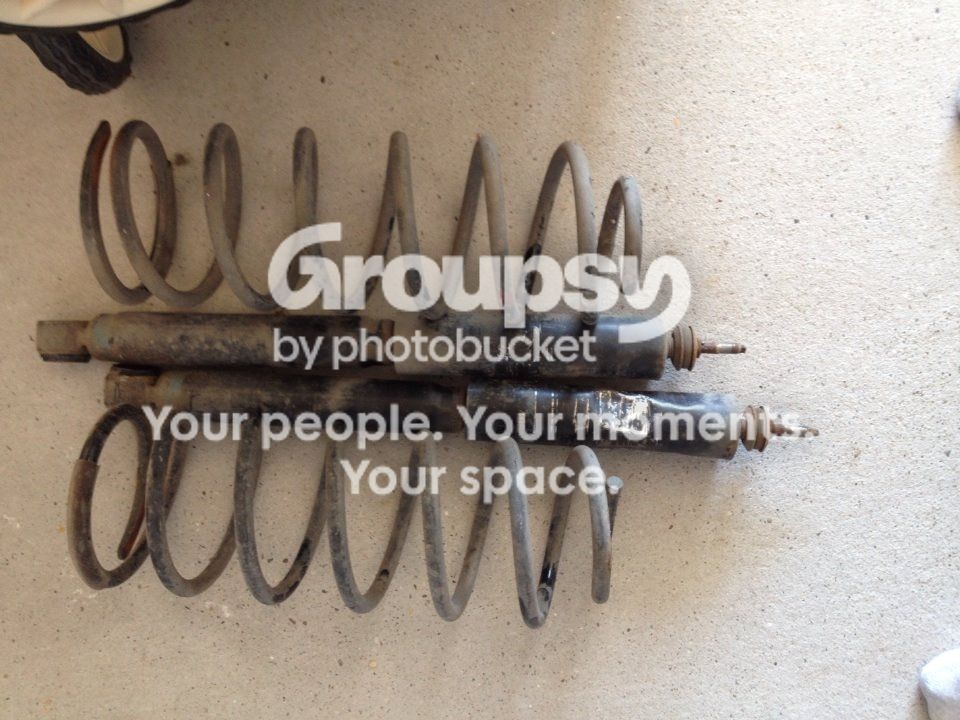

I started with the suspension since it was original and the tires were going bald. I love getting packages in the mail.

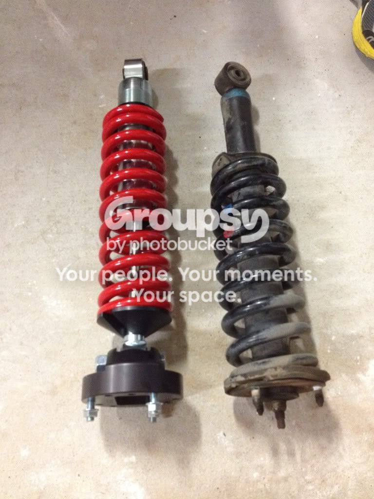

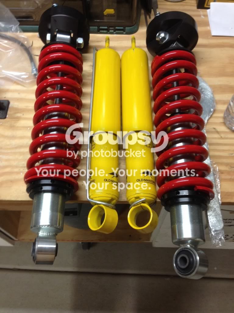

I decided to tackle this by myself. I spent 3 hours on the front. (Toytec BOSS)
Then another 3 on the back. It wasn't hard, just a lesson in patience and tools. (OME 891, Sport shocks)

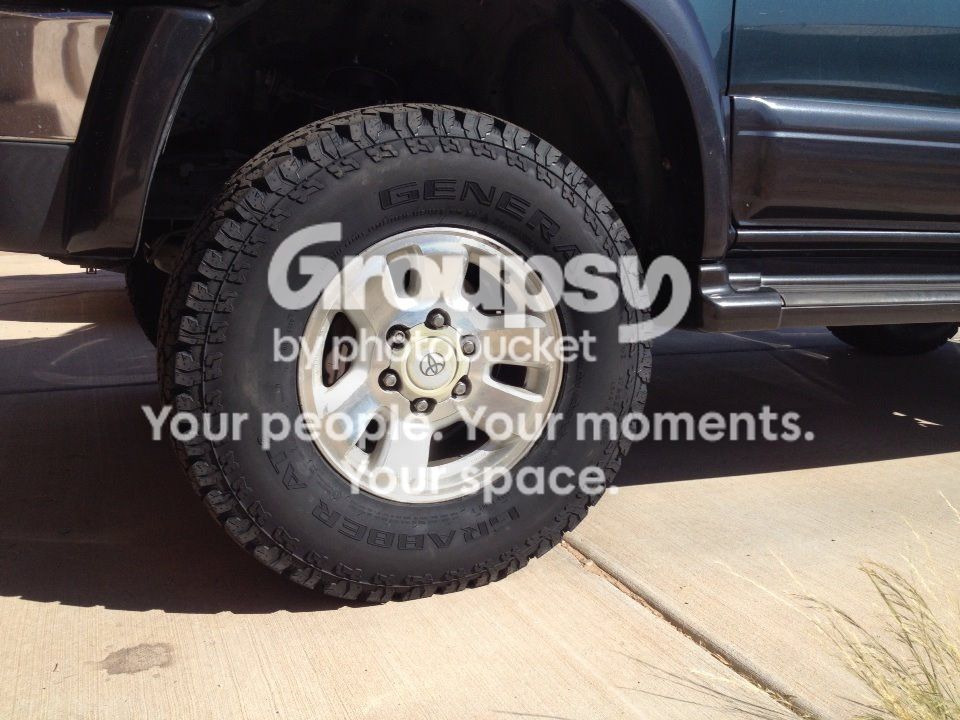

I read a lot about the capabilities inherent to the 4runner so I wanted to stay close to stock for tires, I bought a set of these (General Grabber AT2 267/75R16):

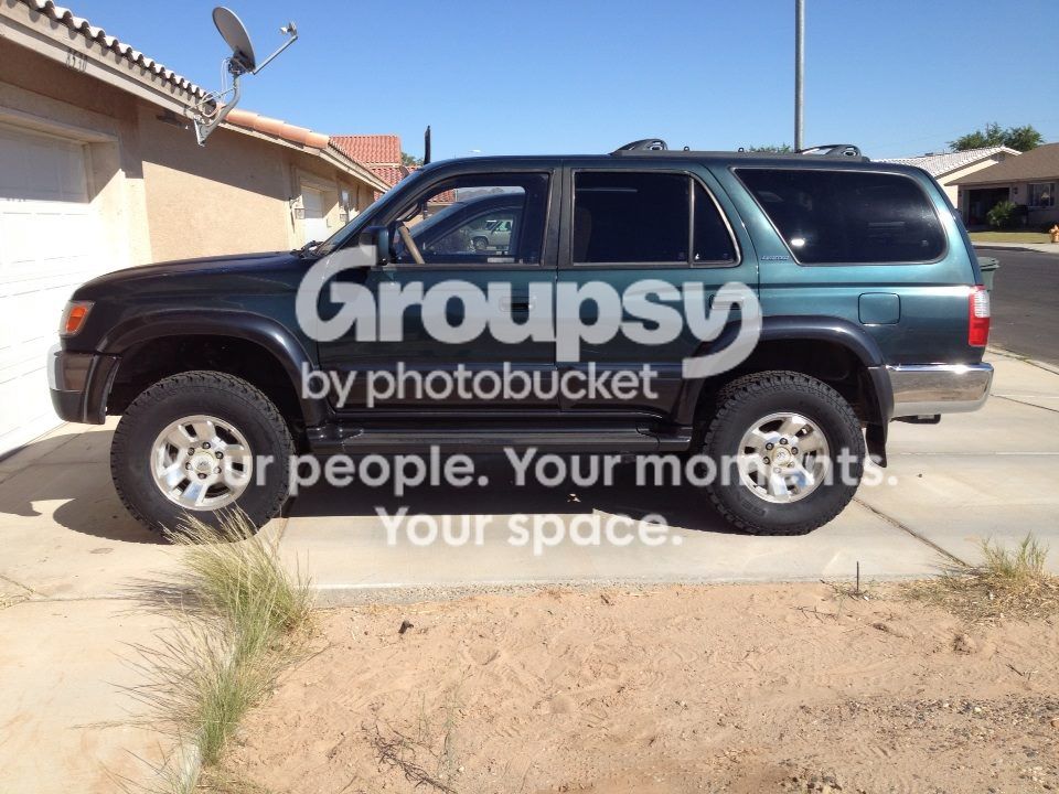

She now looks like this:

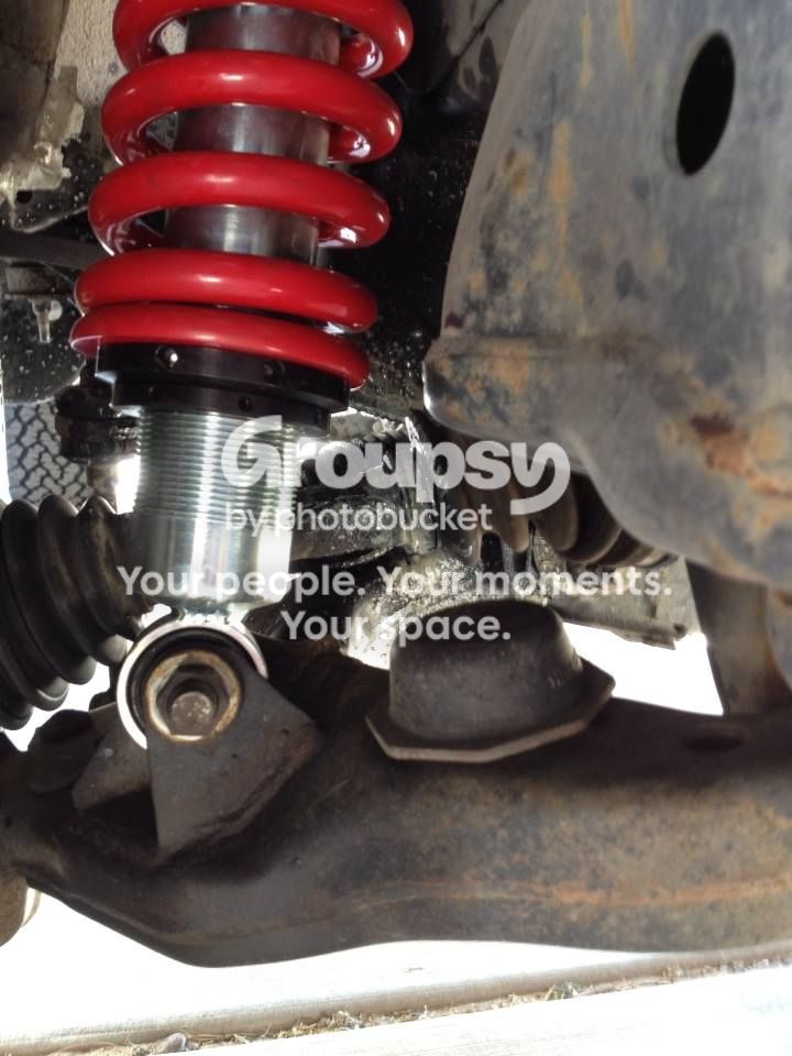

I knew this was coming, but was hoping it wouldn't have been this soon. (30 miles) :bash:
I have limited time for this weekend and have to take it on a road trip. DUCT TAPE and HOSE CLAMPS till next weekend.

Welcome aboard! Nice coil overs! :thumb3:
Downpour11. Thanks. So far I am really happy with how everything has turned out with the BOSS suspension from TOYTEC. I put a couple hundred street miles on it this past weekend and will hopefully get it on some light desert trails this upcoming weekend before I bring it home and start playing with the adjustable coils. Even with the lift and 265/75 r 16's we got 18 mpg's on the trip. Never would have happened in Chevy land where I am from. LOL. Like I said...really happy.

Is there a tear in the boot? Are the CV's shot?
I've noticed that after a lift is put on you tend to get some grease pushing out of the boot. I'd wipe it clean and watch it assuming you have time before the road trip and making a mess out of it with duct tape. Clean, drive, inspect.
Did you install a diff drop? It's not the cause of the grease leaking but if you didn't I'd look into one.
There is no tear in the boots. I believe they were just leaking from the change in angle. I ended up driving them with no duct tape and just did the duct clamps (hose clamps with screw driver thingy : ) ).
Last weekend I went to O'Reilly's and purchased new CV axles. I installed them and found that my old CV's are still good. I will get some new boots on them and have some spares.
