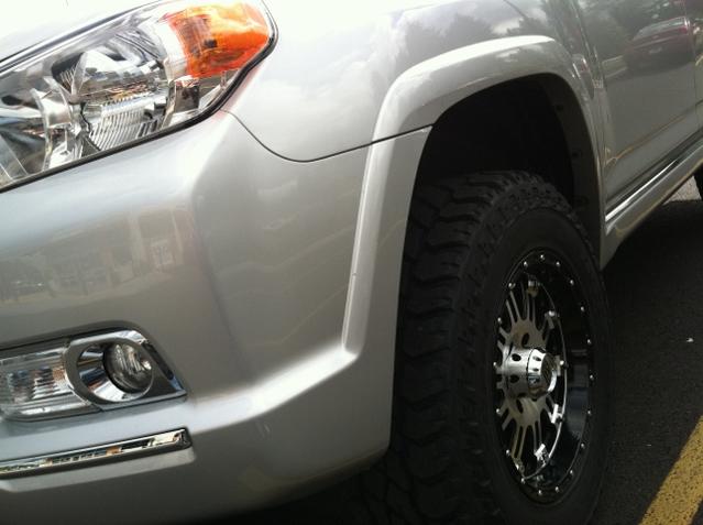

Starting one for myself, to show progress. I started a with a new vehicle further down the thread. The silver one, I got rid of in 2011.
Truck as of now, more to come.....

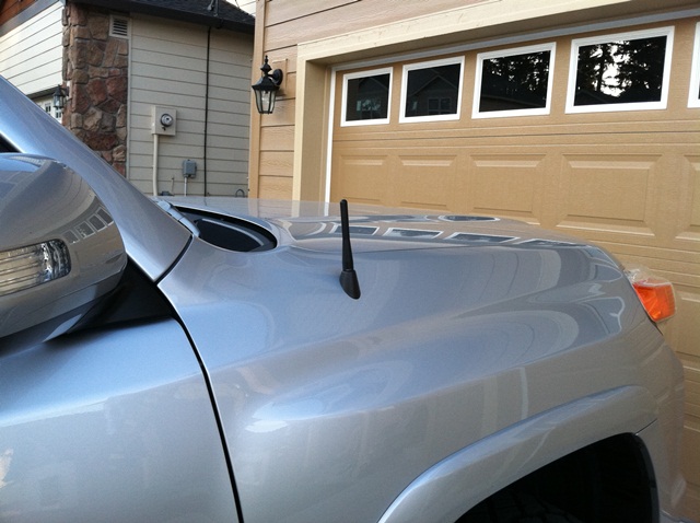

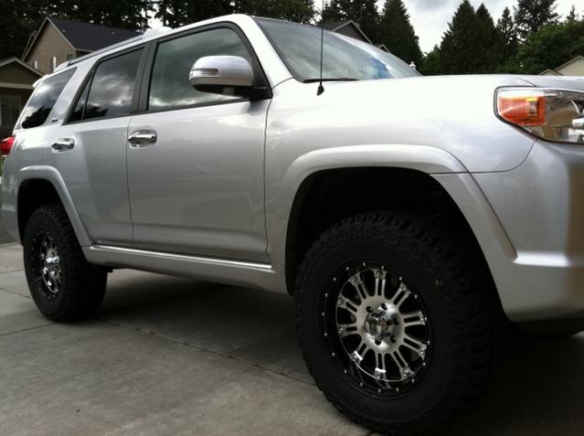

Stubbys were growing on me, so I went and got one. I like the look compared to the nasty long one.

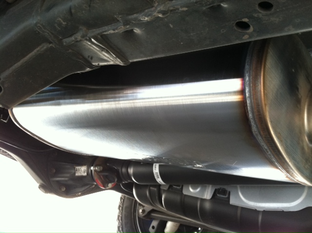

Magnaflow
Installed the Magnaflow 22". Nice low tone, good response and no drone annoyance.

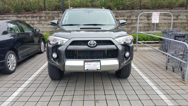

Well its been awhile, sold the 2010 runner due to a unknown suspension issue that Toyota could not fix. So after a few years I found myself getting another 4runner that I had shipped in. Seeing that 5th gens have come a ways since those days, Im excited to venture into this again, only this time with the simple overland build. Not to much........
More to come. Parts are ordered!!!!

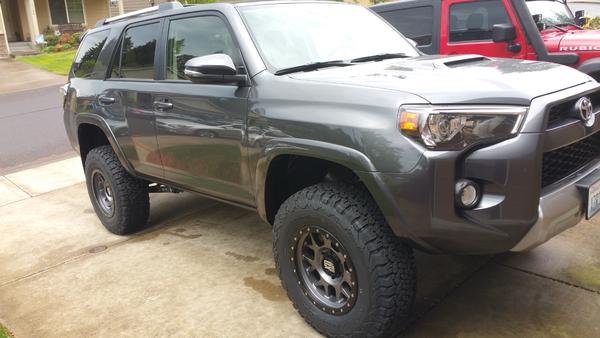

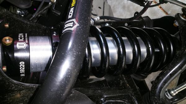

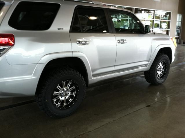

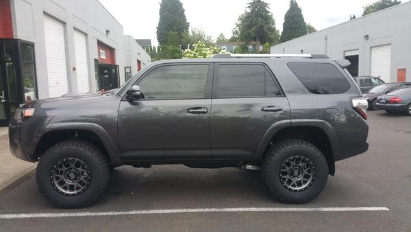

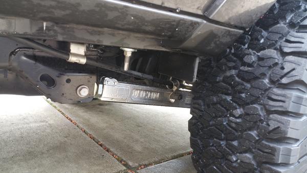

Well today I got the Runner back for the first Mod. Added a ICON Stage 3 lift with KMC XD127 Agent Wheels and BFG KO2 tires. Rides nice no rubs. More to come!! I like how it ended up.

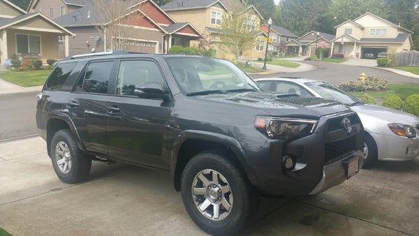

Tinted

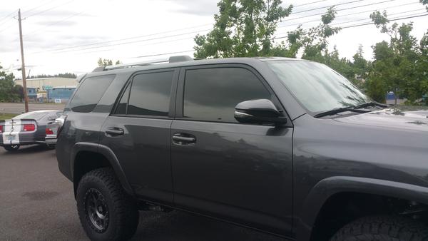

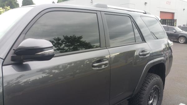

Today I had the Runner tinted with a 20% black. Was nice and darker on the inside. Looks pretty cool on the outside as well. I didn't get a chance to do a before after comparison, however I did get some out of the shop pics of it completed. I think it set it off nicely. New struts came in for the rear door to support the ladder when it goes on. Also coming up will be the ARB re-breather mod. Good write up from [MENTION=120701]Cymon[/MENTION], and the discussion routed me to go this way. http://www.toyota-4runner.org/5th-gen-t4rs/215741-rear-differential-breather-mod-dummies.html

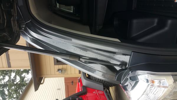

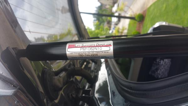

Following [MENTION=138160]Swede71[/MENTION] lead, (http://www.toyota-4runner.org/5th-gen-t4rs/219432-what-best-hd-rear-door-strut-use-ladder.html ), I added Stronger struts in the rear. With a ladder to be installed in the future i figured this would be a good idea.
The struts came from Lift Supports Depot PN: PM1062N10.
The install was fairly simple:

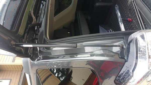

Stock Struts. (sorry for the sidways photos, not sure how to rotate them here on the thread. Even though they are correct in file.)

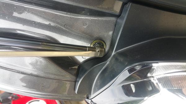

Simply take a flat tip screw driver and release the clip:
After taking both off, I had to extend the door just a little bit more to get the strut to go on. Originally thinking they had a static seal on them I installed one at a time back on. Slowly made sure it would operate correctly by closing the door and opening it back up.
After the first one worked i installed the second one. On these if the insert does not line up, after you install the first insert, rotate clockwise (only) and it will turn and line up.
These will definitely hold the extra weight. Was not expecting the extra lift when I finished it up and testing, as it raised the hatch up like it was lighter then it really is. Cant wait to get that ladder on and see how it handles over all!!
with the ladder on the back I find mine lifts on its own at just the right speed, so not overly fast. And it does not take to much strength to close it
