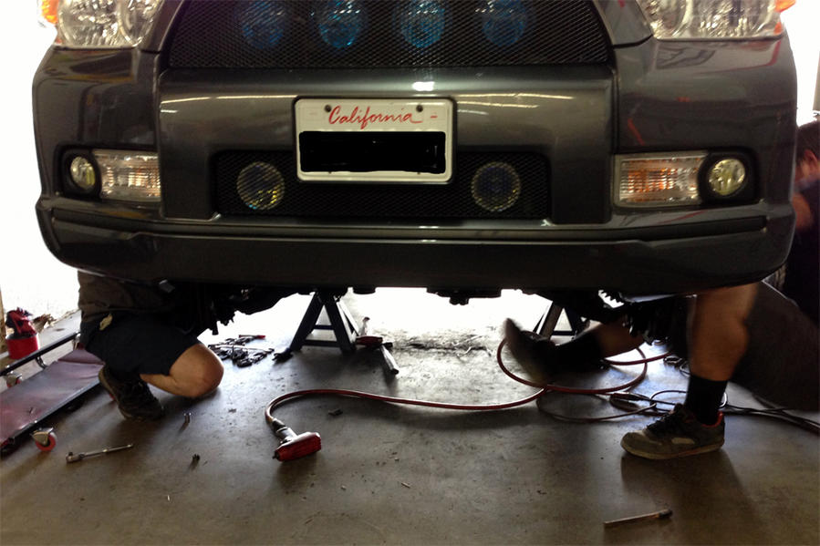

I have Blue and Yellow in both spot and euro configs...these things are bright @ 2500 lumens each.
