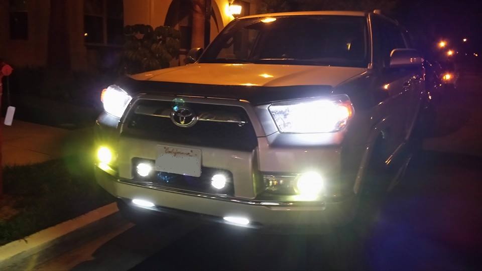

Throw on some HIDs and call it a day. It's worth it. I have 5K up top and 3K for fog.

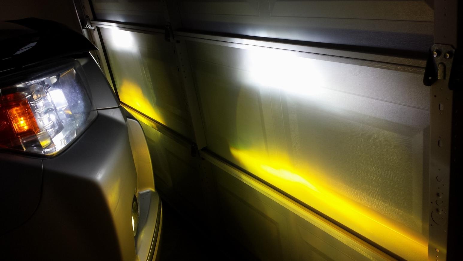

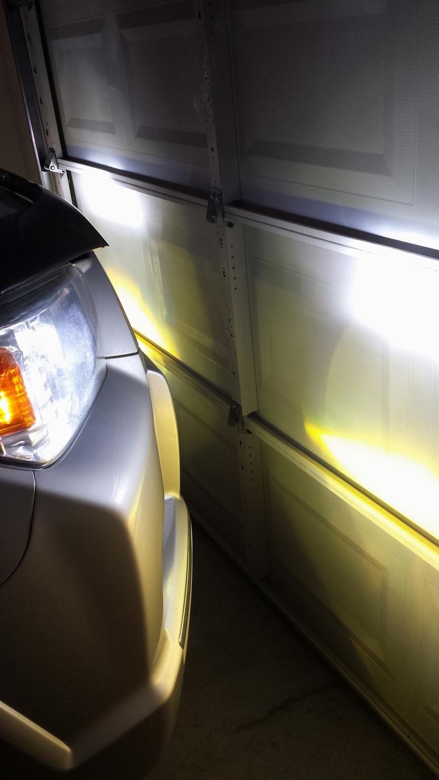

Do you have any output shots against a wall?
Something like this probably:
:jk: :jk: :jk:
I'll keep quiet until I see actual pix, lol

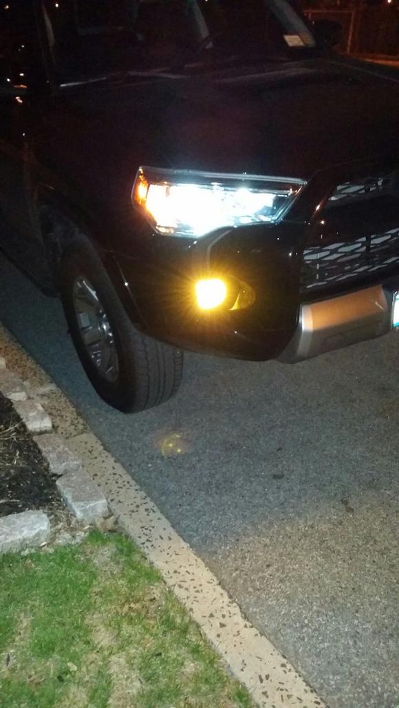

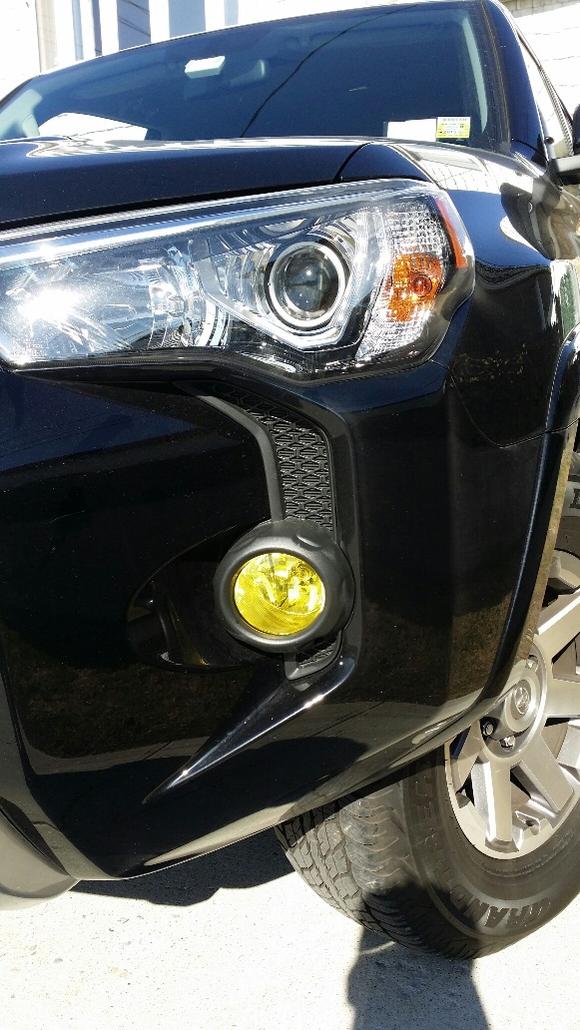

Hey all. I just got my '14 TE 3 weeks ago and wanted some deep yellow fogs similar to the 3000K HIDs I had on my '06, but I was worried about melting the housings / wiring with a higher power setup so I added some yellow lamin-x and Piaa H16 Ion Crystal bulbs. I love the deep yellow that the combination produces to contrast my 5000K HIDs, but there's little usable light. Here's a day and night pic (not the best phone shots) ... For those of you who used an HID kit in lieu of the 19W H16s, have you noticed any fuse / wiring or housing issues?
