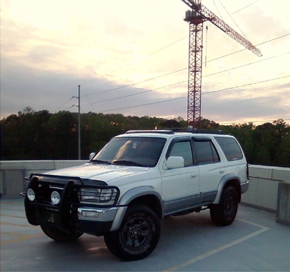

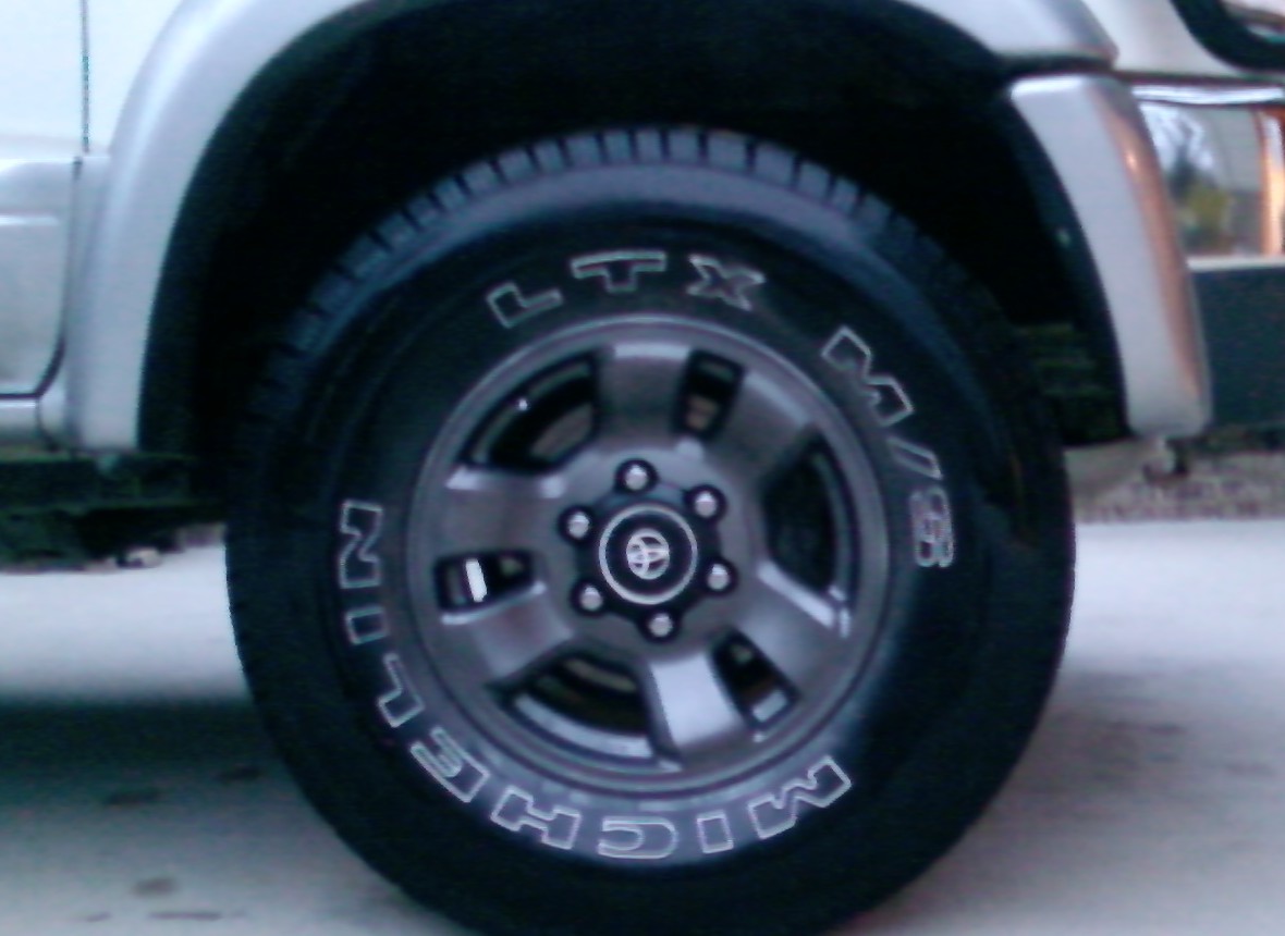

I'd go with gunmetal... I did and it looks bada$$... Sorry for the bad pic, cell phone

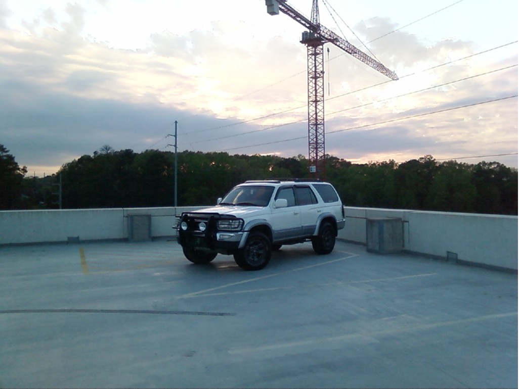

haha yeah guys i'm worknig on it, i have a few mods to update, debadged, black emblems, etc. no camera though!!!!!:bash:
ok so here's another cell pic, a little better...
