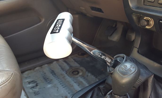

I wish my aluminum shifter was warm in the winter, its like ice till I'm running for a half hour.
