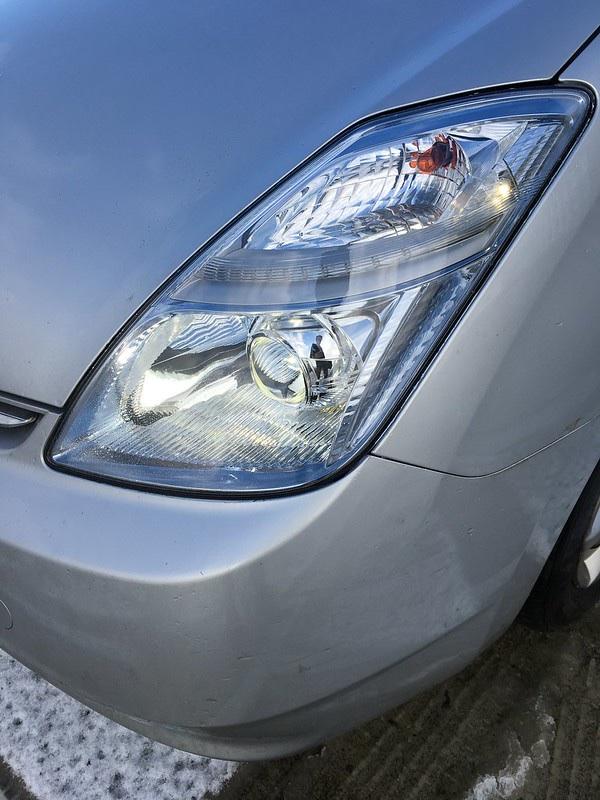

5000K, while the purest typing-paper white, is largely unachievable with most, if not all halogen and LED offerings. This space has only consistently been served with HID bulbs (xenon type D1S/D1R through D4S).
Think early Toyota Prius, Sienna, Avalon HIDs. These were beautiful colors:
LEDs typically in the 4-5000k range have filters or films to make them yellower, reducing output. Same goes for halogens above about 4000k - they have filters to make them bluer, reducing output.
