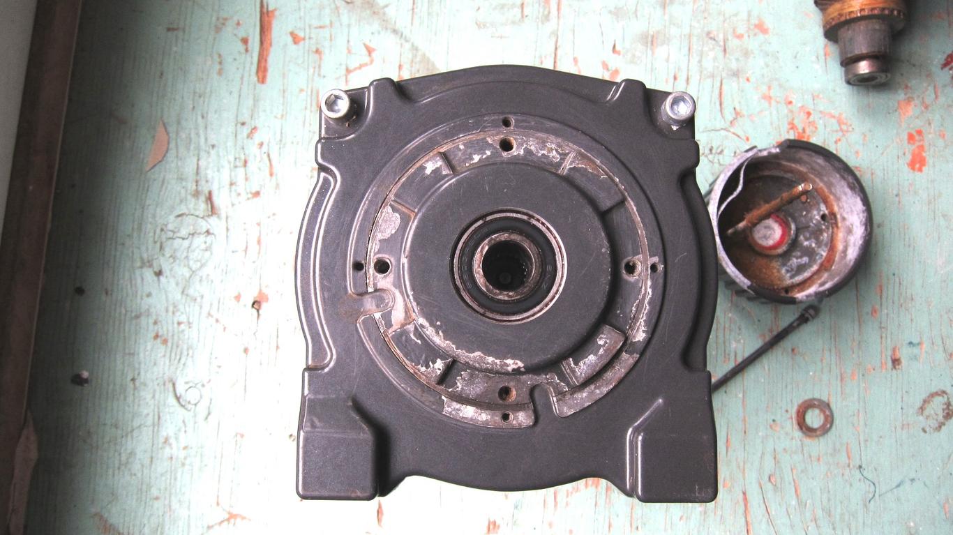

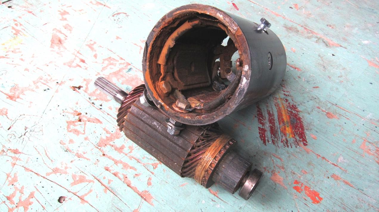

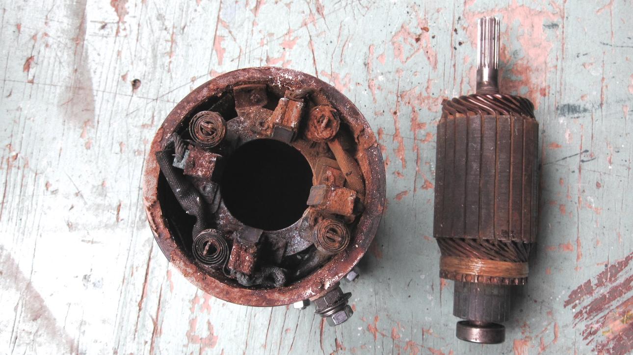

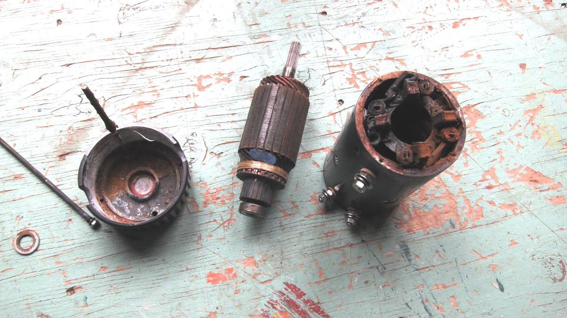

My winch stopped working a few months ago and I finally got a chance to pull it and investigate. I could hear the solenoids engaging but nothing happening with the winch motor.
The winch was purchased new in 2012 and installed in a Shrockworks bumper. That particular installation keeps the winch well protected from the elements with its only direct exposure being through the fairlead. It was mounted in a "foot forward" orientation as opposed to the "foot down" orientation that is intended when the winch ships from the factory.
Here's what I found when I pulled the motor:
So I called Warn with the intent of getting some sort of warranty service and instead learned that I was the one who caused the problem and how to avoid it in the future.

So the deal is: IF YOU ARE GOING TO MOUNT THE WINCH IN A FOOT FORWARD POSITION, YOU NEED TO PULL THE MOTOR AND CHANGE THE DRAIN HOLES. The attached pdf file shows you what you need to do to change how the motor housing drains accumulated moisture. The photo below is my winch with both drain passages open. I'll seal the one that will be facing forward before installing the new motor.
To orient you; the photo is showing you the left end of the winch frame while looking down on the winch as it is installed. This is the end the motor is attached to. The right side of photo is up, the bottom of the photo is facing forward as the winch is installed.
