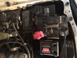

Did you end up relocating the solenoid? I have a Shrockworks bumper and I just picked up an M8000-S winch. Thinking about that position next to the battery the way Ritchie did it...
I did. Made a bracket for it And hung it off the battery. Let me know if you want more pics

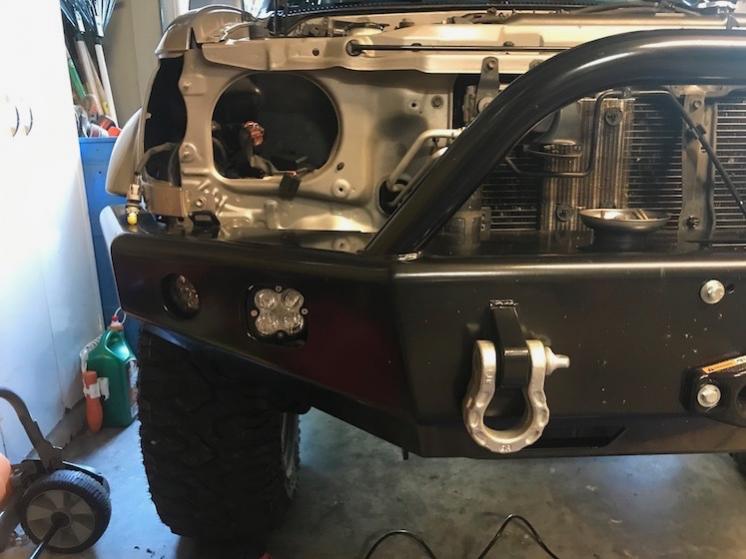

After A LOT of deliberation and being a bit annoyed like [MENTION=116467]Rock_Rat[/MENTION], I did the same as [MENTION=101060]Spunk[/MENTION]. I ultimately thought it was by far and away the better location to keep the engine area open enough for other options and make it easy to remove the bumper in one piece, but also a HUGE PITA to do.
The most effective way I found to make it fit was to install the bumper first and then remove the passenger headlight assembly. Once that was done I could drop the control pack into the bumper cavity behind the fog light and spin it into place. I may eventually do a full writeup, but only the next time I have to take the bumper off, here is the overview. There are some differences because I bought a VR8000, paid $300 new, so it was hard to skip.
  1. Clock the winch
  2. Remove the control pack from the winch
  3. Install the winch into the bumper
  4. Install the bumper (I don't see how you can mount the control pack in this area and accommodate the tight tolerances starting off the vehicle)
  5. Use 2-4 AWG to extend the length of the three control leads (Yellow/Blue/Green) from the control pack to the winch by about 8 inches BUT DO NOT reassemble the CP just yet, other than putting the plastic/metal case back on - leave the control leads off. Keep the original wires for the Big-4 upgrade if you want.
  6. 'Dry-fitting'
    • Remove the grill and the passenger headlight assembly
    • Using the Shrockworks solenoid bracket: back out the top bolt on the SW bumper bracket and mount the solenoid bracket loosely into the same void as the fog/turn lights. DO NOT TIGHTEN. I can't recall, but I think I had to open up the bracket mounting point for this to work.
    • Mount the control pack to the WARN mounting plate (designed for ZEON winches, WAR97890). M8000 may not have something like this so you may need to make your own. You will ultimately need to drill new mounting holes in this WARN plate to identify the final install location by whatever amount you need, but at $9 it was worth the $ to have something mostly right. This is where 'dry fitting' the assembly into the final mounting location is required to accommodate your setup.

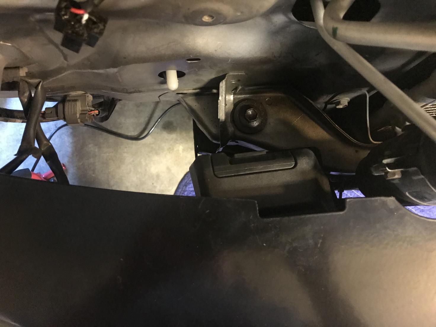

    • This is the tricky bit. Drop the CP into the cavity between the windshield washer reservoir and the foglight and mostly blind spin it around until the CP remote port is facing the reservoir/radiator. This places the control socket in the most accessible location and puts the control leads closest to the mouse-hole (there is a large chase/mouse-hole in the front of the internal bumper support).
    • Be aware that the control leads will need room to flex to make it through the bumper's structure (mouse-hole). So don't tight fit this to the bracket. YOU MAY CHOOSE to reassemble the CP (install the control leads) to perform this fitting, but it only enhances the PITA status. I ultimately did this, but only after first gaining valuable insight without the leads installed, YMMV.
    • Once your good, mark-up/make a mental note of where you need to drill new holes in the CP plate and remove the kit from the bumper.
  7. Remove the CP from the WARN plate and drill your holes, or make your own bracket as you see fit. I JB welded some SS screws to the plate and used self-locking nuts to keep this in place during final tightening.
  8. Reassemble the CP if you haven't already, and mount it to the CP bracket. You can do final tightening for this assembly.
  9. Put everything back into place just like you had it and tighten down. To be very clear, apart from the CP plate being tight to the CP, EVERYTHING ELSE HAS TO BE KEPT LOOSE UNTIL YOU GET IT INTO PLACE. then while it's in the bumper, where you can't see anything, and operate mostly by feel tighten it all up... PITA.

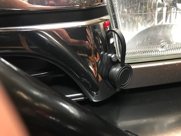

  10. I used the WARN remote socket extension kit (100154) to place the socket in a location the may very well be temporary. I drilled an install location into the lower driver's side grill. It lets me operate the winch from outside the vehicle or cab with the handheld. I'll also install hardwired in-cab controls later.
NOTE: In final assembled locations, the CP is rock solid and very square to the body. So this seems to work well and has held up so far. The image below shows the CP slightly ajar because I only have two hands and it is resting on the fog light and the body of the truck so I could take the photo. I did ultimately place a little Velcro fuzz on the radiator support below the CP where the CP could conceivably tap due to vibration. Also, when a full writeup does occur you may be able to do this installation without the bumper on the truck - or attempt it even without the writeup. But to get to this point required some exploratory poking around. If curious I ordered 1" shackle mounts from SW when I bought the bumper.

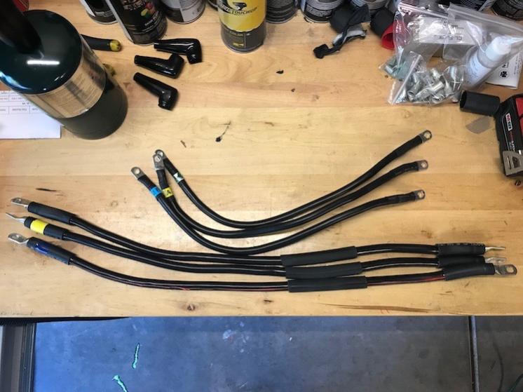

I had a local shop weigh in and they did an amazing job of fabricating a bracket for my controller as well as longer cables. Love the way this turned out.
Sent from my SM-G965U1 using Tapatalk
I relocated my control box with $5 worth of aluminum flat bar from Home Depot and a spare screw from the skid plate (the truck's body already had the hole pre-tapped). I also bought longer cable from a welding supply store to hook it all up.
