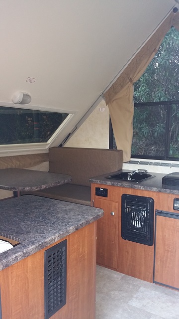

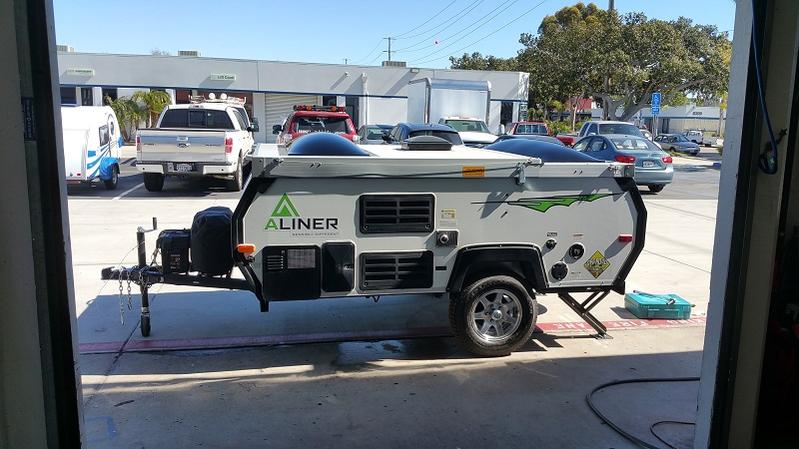

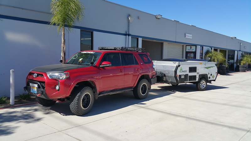

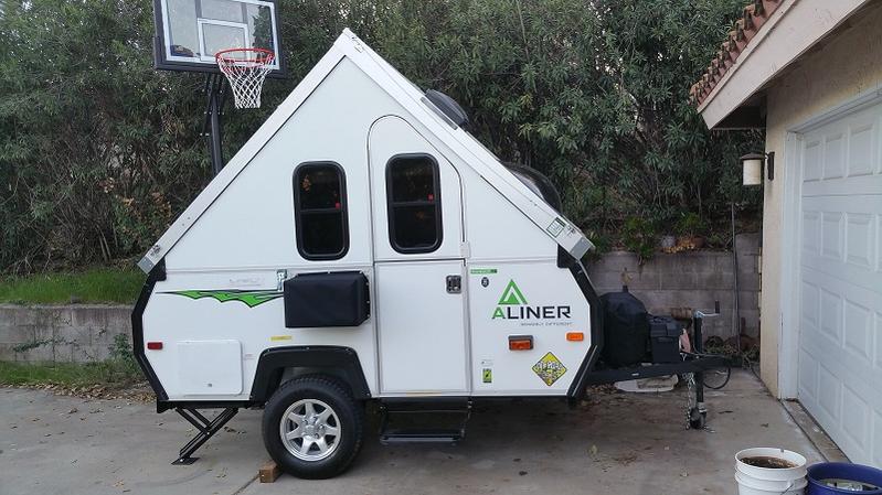

New trailer!
Finally after several months of hemming and hawing about weather to get a camp trailer and if so what kind, I picked this up yesterday secretly to surprise the wife with on her birthday. (We looked at them last weekend)
Aline Ranger 10 with split bed/table. High wind and offroad options (Probably common for all sold in so cal due to desert camping :D)
We're getting a bit older and kind of over tent camping which is great when it's nice but kind of miserable in bad weather (Especially 50 mph thunder storm cells!)
I LOVE the warm security of sleeping on my bed in the back of a runner so we were looking for something to house two people.
It's small but surprisingly roomy inside! Light weight and compact for towing.
All that brown cloth has to go, Wife is already planning on reupholstering the cushions and replacing the drapes :)
Still need to shop for sundries and such before doing a test run. But so far this is my good/bad list:
Good:
* Compact, can see over top when towing
* Light weight, 1400 lbs
* Came with dual propane tanks and good large Interstate deep cycle battery.
* Heating and air conditioning
* Hot water heater
* Solar input
* Shower (Outside)
* Lots of windows, great views outside while inside hiding from the wind, cold or rain.
* Propane/AC/DC fridge.
* Stove
* Fair amount of storage for non-daily accessible items.
* Hitch looks very sturdy.
* CO and Fire alarms
* Tank and AC condenser covers
* "Offroad kit", larger knobbier tires, heavier duty axel and springs and e-brakes.
* Beds have plenty of head/leg room for a 6' person.
Bad:
* Some cheap materials but largely due to weight savings.
* Some bad workmanship here and there. Need to redo some caulking and Velcro.
* Need to check all the wiring carefully, the crimp connectors used at the battery are terrible! Definitely soldering those solidly.
* No 12v sockets.
* No receiver hitch on the rear.
* limited easy access storage for pots/pans and food, will have to be extra clever about building in shelving or other compact storage.
* headroom at the table is a teeny bit limiting due to the sloping ceiling.
* External waste water tank needed (Well this is a teeny thing so that makes sense)
And overall got it for a nice price, was 2 grand off of the last time we went to look at it. Also looked at a T@B which was a bit finer in workmanship and had an indoor shower/bathroom, but was 10 grand more and you felt like you were in the dark/closed in on the inside. Also the beds were EXACTLY 6' so may not be as comfortable. This thing is light, roomy and open with all the windows.
I just realize that I'll have to be a little more "handy" with it as time goes on :)
First mods!
* Nicer looking cushions and drapes.
* Internal lighter sockets and inverter.
* Check and secure all wiring.
* Check and redo caulking on underside where some of it is sloppy.
* Outdoor lighting
* Figure out some way to mount my smittybilt awning
* Make a luggage rack for the back bumper for holding gas cans wood, etc.

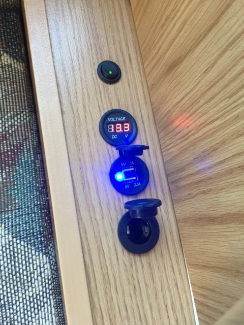

You can get these on Amazon for cheap and you can either use the mounting plate or install them without it. I added them to my pop up to see voltage and for charging phones and such inside.
Pretty straight forward install, I added a switch to keep them from drawing current when not in use.
Nice! I'm going to be picking up stuff to add sockets today, I'll keep my eye out for some gauges. Though I'll probably have to amazon for that as well...

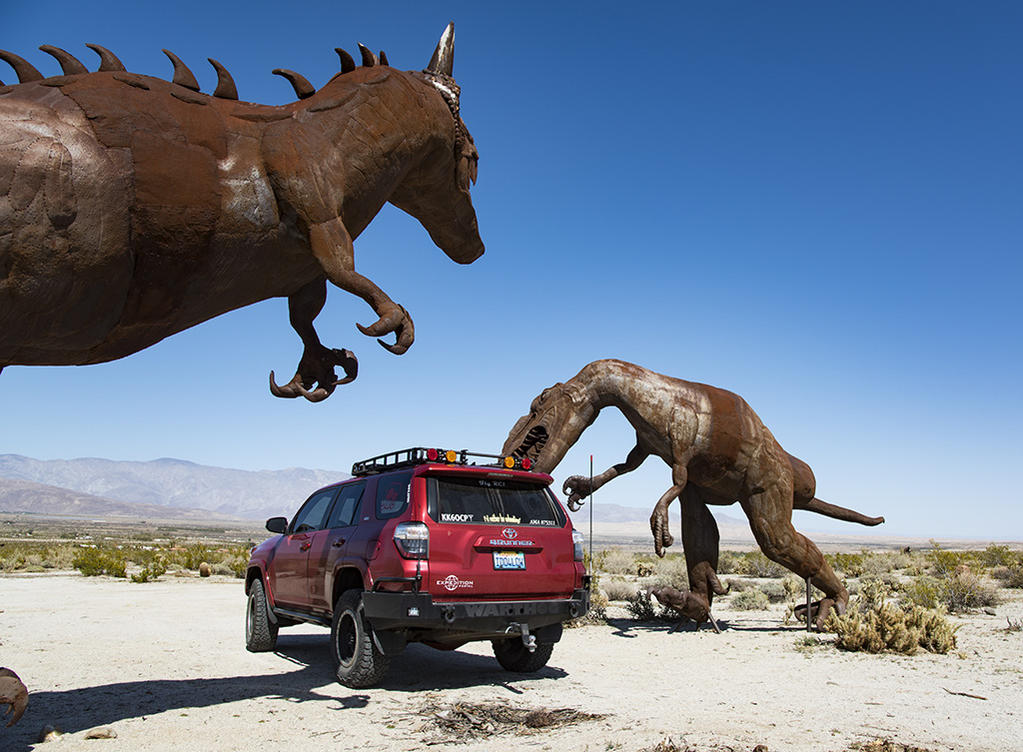

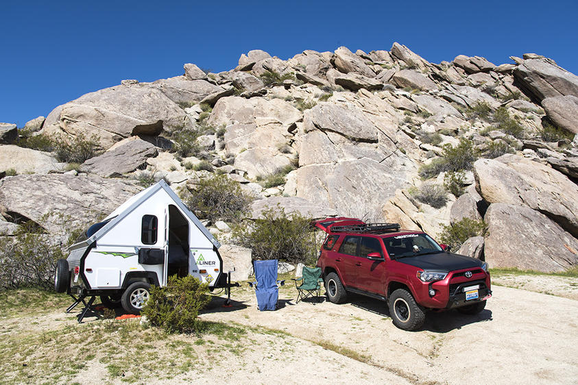

Shakedown Cruise for the camper
Took the camper to Little Blair Valley for a single overnight test. The Warthog is so domesticated now!
Sunny and warm with a gusty cold wind. In fact got a really good gusty windstorm for an hour or so in the middle of the night. Had the trailer rocking a bit but not bad. WAY better than being in a tent in that situation :D
Other than forgetting TP (Though I remembered the portable toilet) and a couple of other things it was a good success.
Saturday we went in to Borrego where they were having their yearly outdoor art show which was nice. Then toured all the metal sculptures spread out in the desert around the city.
I took a bunch of pictures but, as this is the T4R forum, I'll just leave these two here...
The trailer pulls really well, it's small stature when folded meant I could take it on the short entrance to LBV which was nice, 1/5th the length of going through Big Blair Valley.
The only time I really felt much behind me was when braking or going up hill. Took to manually shifting to keep the Rs up and the tranny cool. But that really sucks the gas mileage. Looks like I got 13.5 from San Diego to LBV. That's a drop of 4 mpg over not pulling anything.
QUESTION: For anyone else that tows, have you relocated the trailer electrical socket? What did you do to extend the wiring for it?
In the cold morning the cord on the trailer was like 3 inches shorter than when I last towed in the middle of the day. It would BARELY socket under the bumper and a sharp right turn would have pulled it out. :(
