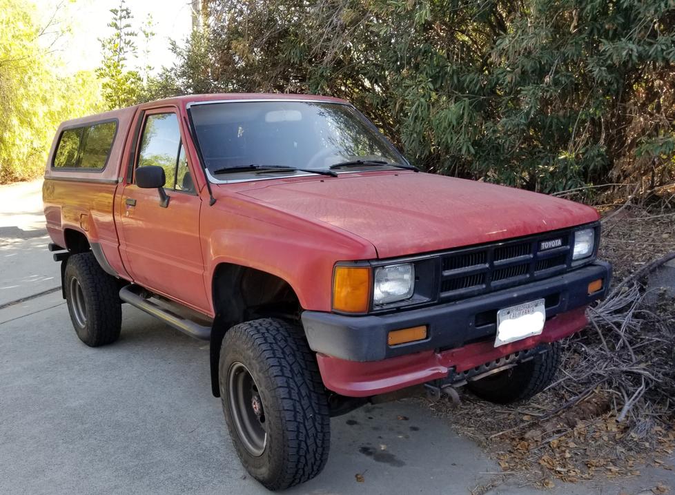

Lastly, I recently re-acquired my first Toyota 4x4. A 1986 standard cab SR5 pickup, carborated 22R, sadly not straight axle. My friend that I gave it to 15 years ago did an ok job keeping the fluids up and replacing things when they went bad but not much else, it's in some dire shape inside and under the hood. Nothing was cleaned at all in 15 years :(
Luckily! I live on the west coast so no road salt, the frame is virtually spotless rust wise. The body is just barely starting to show some, and the bed had a few bigger spots, but still far from anything drastic.
I spent the last 4 days and about $300 fixing up the engines worst problems.

I still need to replace a torn CV boot but the only thing left outside of the cab that I am not happy about mechanical-wise are the brakes. It's currently got 31s on it and I'd like to put some 33's or 32's at least, but the stopping power is pretty weak (Well compared to the 4 wheel disk braked warthog) Factory tires are like 28 in! I'll need to look into improving the brakes somehow before upping the tire size, any suggestions?
Anyway, that's what I've been up too. Not sure if I can start a "fake runner" build thread for the truck here, I might have to move off to ToyotaNation or something! For now I'm just getting back to being a pleasant drive, but I have vague plans for turning it into a truggy. :D

Glad to see an update on the Warthog! Old truck looks awesome. Could keep that build on this thread maybe, or start one in the Classic T4R's section since it might as well be one.
