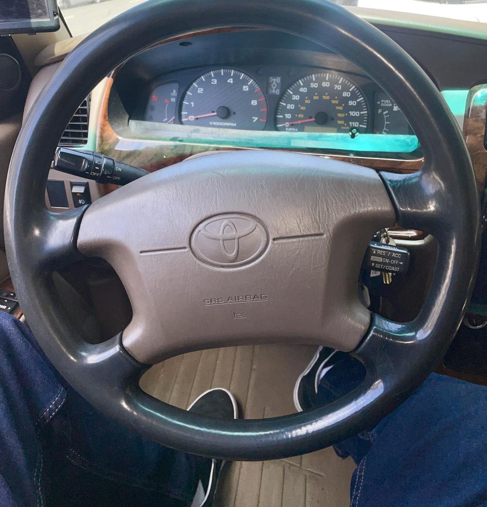

So, I grabbed a steering wheel off what I thought was a black 1999 S5R at a PYP yard on an overcast day last weekend. When I installed it in the sun yesterday, it seems to have a green hue (that doesn't fully come through in pictures) especially when next to my tan airbag. Are my eyes playing tricks on me? The wheel has a smooth and somewhat squishy texture and feels so much better than my totally worn out leather Limited wheel did. Did they come in 'green'? Maybe I'm just old.....

That's just wear/age. The non-leather wheel originally had a texture nearly the same as the leather, but that wears down smooth with age. The outer black layer is just getting thin and the inner lighter foam is starting to show a bit. Still better than a busted leather wheel - but now is your time/chance to put new leather on the original wheel:
Toyota 4Runner LEATHER WHEEL KIT 1994 -97,98-03.02-09 OE Covers spokes | eBay
-Charlie
LOL - OK, thanks for clearing that up. To be honest, I once tried to install a leather wheel-cover kit on my 2nd Gen and gave up. I'll run this $25 junkyard wheel until I find a find a fancy wood one on a Lexus. I can sew pretty well by hand to do a repair, but I see a lot of frustration ahead with another wheel-cover kit (although that one looks very nice!).
