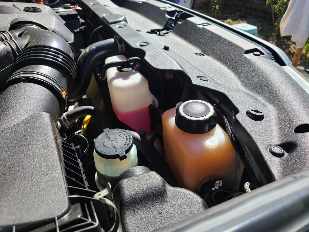

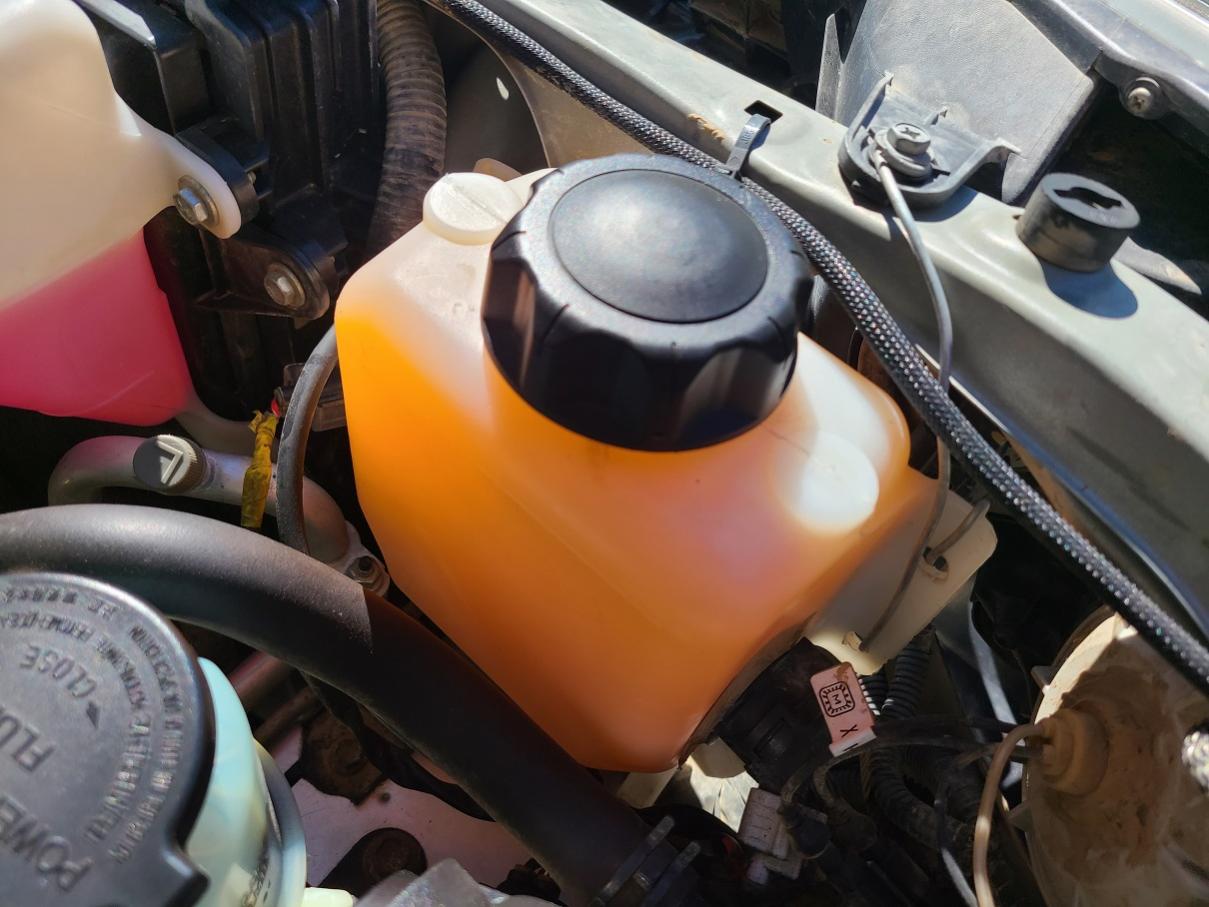

I did a relocation myself with a $25.00 plastic reservoir from US Plastics. Got some steel wire from Home Depot and utilized the existing holes on the body to mount the reservoir. Less capacity than the OEM reservoir but it has worked for me even for week long road trips. Mine has never leaked and it's gone up pretty high in elevation at 9k+ with no issue. You'll need to drill two holes and use weatherproof silicone to seal the pumps.
1.5 Quart Natural Multi Purpose Tank with Mounting Tabs - 7.74" L x 3.62" W x 5.9" Hgt. (2.25" Neck) | U.S. Plastic Corp. and you need the appropriate cap too.
I'll post some photos later.
Thank you! Tank is like $5. Just need to know what cap to use and I’d be done.
Looking forward to pics

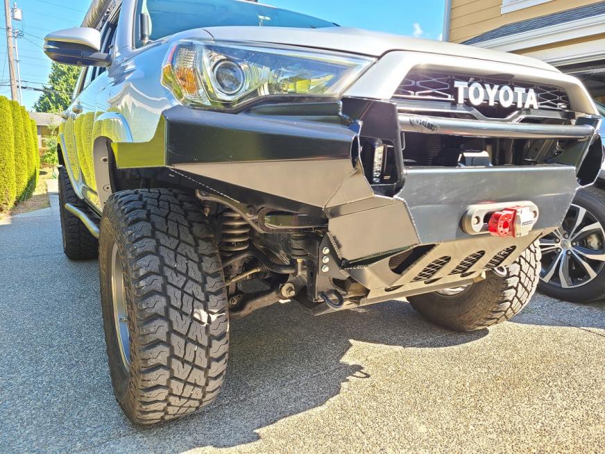

I didn't relocate, but I did get the protection plate from CBI when I did my bumper. Depending on the concern, it may be an option.
You can actually buy washer fluid bags with a built in pump that mount anywhere. Just run your tubing to the bottom of the bag.
No exposed reservoir, wires and pump lines dangling when you're running a high clearance bumper.
Definitely a better option than spending $250 on a kit. What cap did you say fit this?
