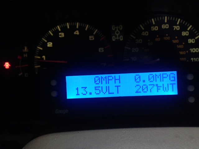

Hi Guys,
just curious regarding what the Water/coolant you guys see on your scangauge on avg?
I just put the charger in and I don't know if my mind is playing tricks on me but the fWT on my scangauge seems a bit higher than normal. I've seen it go as high as 207... on avg it sits around 202.

Yeah, thinking about getting the lower thermostat just to have protection. I am in Texas which is starting to get into the 90s. But should this be any concern for me seeing this high temp on the gauge or I guess the real question, is this something I should address as an issue?
I have attached pic.

205-207 is a bit warm but not dangerous.
In fact the stock temp guage doesn't even go into the red until after hitting 225 or 230 F.
When I had air in my system it was running at 205 all the time. It would flux between 199 to 207.
Now that all the air is properly burped it runs 185 to 199 depending on the conditions.

Here's my personal experience after doing some work on the 4Runner this weekend. I installed a new timing belt, tensioner, waterpump, radiator, and thermostat. My old thermostat was installed upside down (jiggle valve at 12 oclock) and my coolant hadn't been changed in 90k I believe... Before all this I was running 205ish, and now I'm running 186-190 on the dot, the only time it goes over is if I shut it off for 5 minutes and it has time to heat soak, but as soon as it gets turned back on it goes back down.
Once it warms up mine fluctuates between 184 and 188. No higher, no lower, and that's in temperatures ranging from 20-100 degrees F. If I saw 207 on my truck I'd be certain something wasn't working like it should be.
