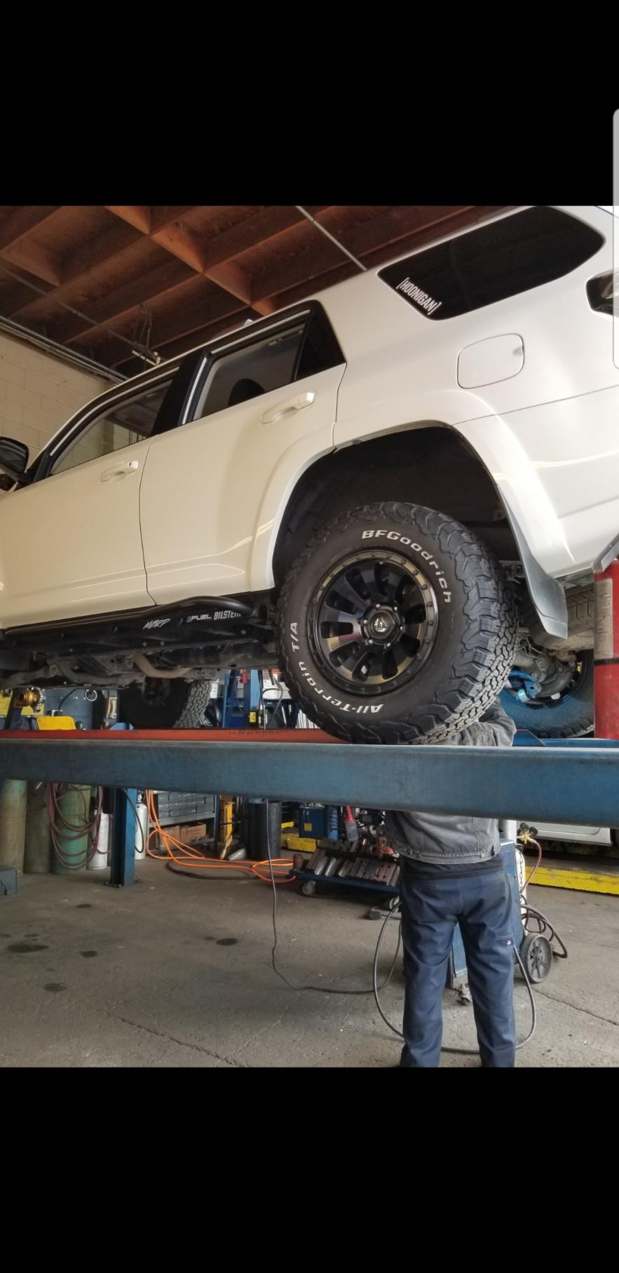

Screw clamps...getting this sealed right
