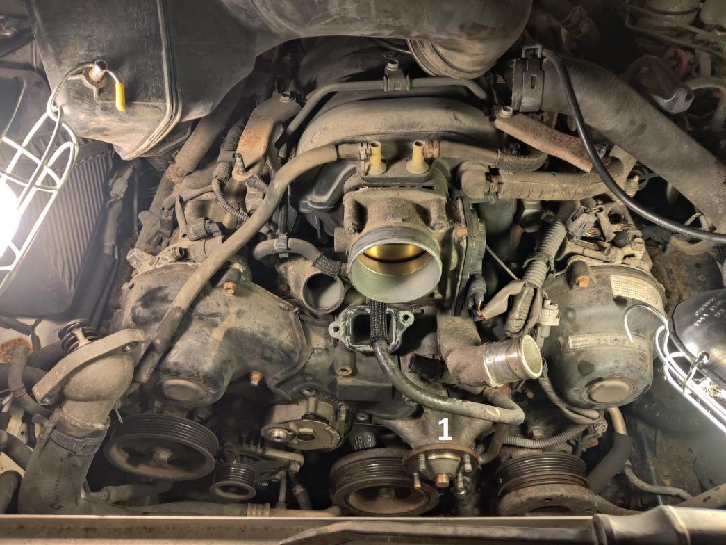

So I've made it this far (attached) by following this video (for V6): https://www.youtube.com/watch?v=-5Jeyw1cyS4
I believe at this point the remainder of the fan assembly (1) has to be removed and from there I'm not sure where to go. After going down the YouTube rabbit hole again, I'm running into "timing belt and water belt replacement". This is adding a layer of confusion for me, as I'm not sure if all of the accessories, covers, and timing belt need to come off to get this out?
Can anyone reference a write up or video for water pump removal on the 4.7?

Water pump and timing belt are generally done at the same time. Why are you only replacing the water pump?
The water pump needs to come off before you get to the timing belt either way, so those videos should help.
If you don't replace the timing belt at the same time you risk it breaking later on especially if the timing belt hasn't been replaced recently (Toyota calls for replacing the timing belt every 90,000 miles as normal maintenance) , if it does break it will make the valves hit the pistons at which point the engine is toast and will need to be replaced, much cheaper and good insurance to just go ahead and replace the timing belt when doing the water pump.
