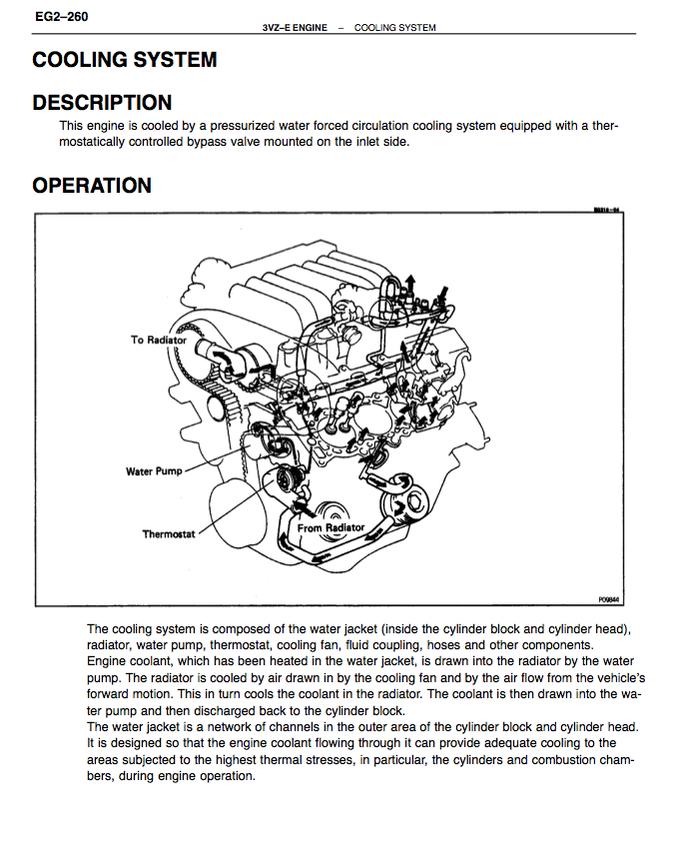

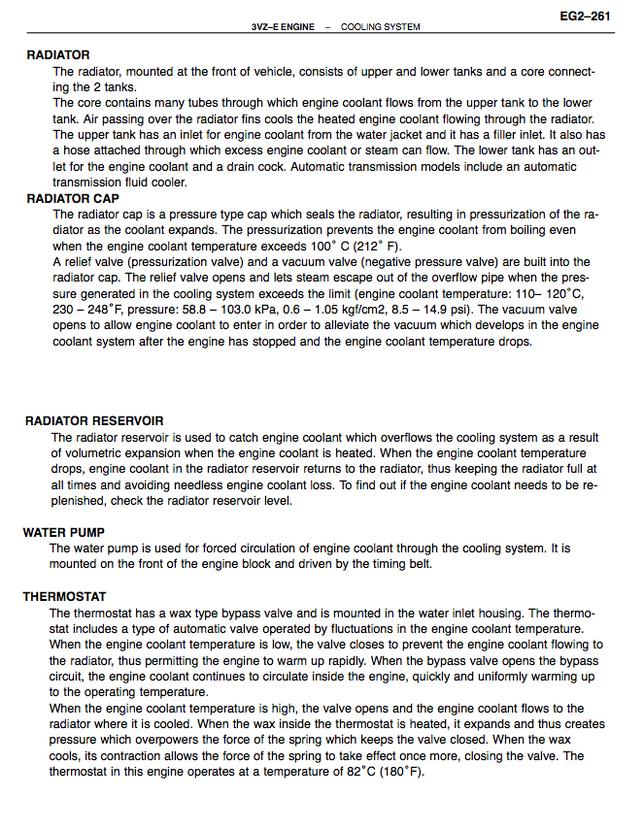

Question on the thermostat placement for the 3vZE: I always thought that the thermostat opened and then allowed flow through it in the direction of the radiator. However, I heard that the flow from the engine is into the top of the radiator and then the cooler fluid is out the bottom of the radiator to the thermostat. So my question is, how does the thermostat "sense" the hot temperature if it's in contact with the 'cooled' flow off the bottom of the radiator? The jiggle valve would also allow a small amount of flow from the bottom of the radiator, through the tstat to the opposite side of the tstat. Am I thinking about this correctly??? THanks for any clarity! I can't find a flow path anywhere for this cooling system.
Here you go man. The "sensing" portion of the thermostat is in contact with the coolant already present in the engine water jacket. When it reaches the opening temp of the t-stat it allows cooler coolant to flow to the water pump. The inlet for the engine cooling comes from the bottom of the radiator, thru the t-stat, thru the water pump, thru the engine water jackets and back to the radiator from the top. With is being a pressurized system if you close it off at any point the flow stops.
