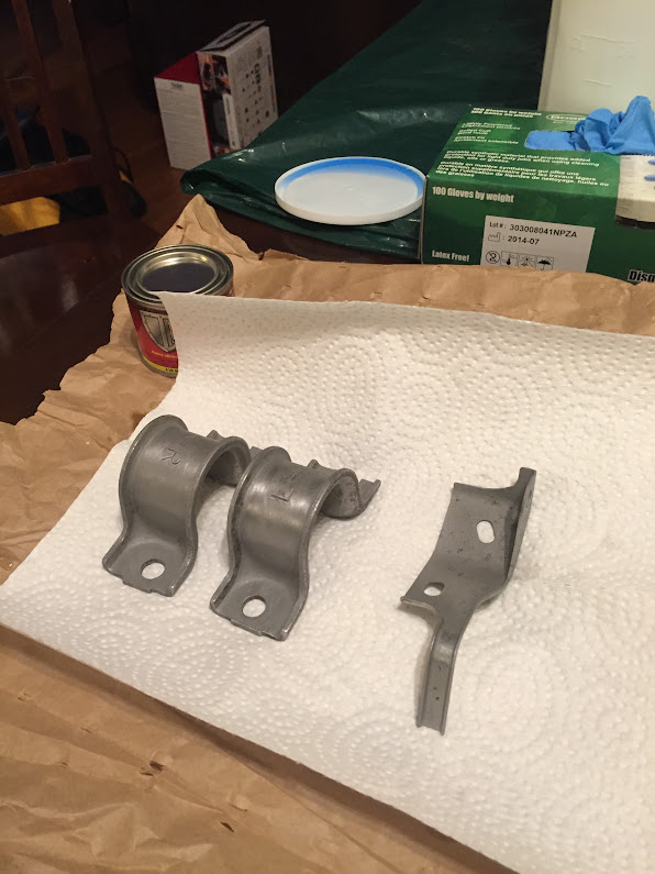

These are a few items that I thought I might try out with the paint (POR15), since I don't have access to the shop tonight. They were sandblasted, and then lightly sanded with 180 grit paper. This is them after the cleaning compound was washed off (part of the por15 process).
IlPBn7faS1yqw9MImvzfG3E9-dIucpreFwJNC4A8t7E=w1060-h795-no
Even though POR says that metal etching isn't really necessary with a sandblasted bare metal, I decided to go ahead and do it anyhow, to see what happened. The phosphoric acid etches the metal a bit, and leaves a kind of a ferned pattern on some of the metal. It turns any rust to a black very hard material, basically swapping the iron oxide for iron phosphate (if I have this wrong, I am happy to be corrected. I did a biochem degree not chemistry and it's been a while since I gave a shit).
I talked on the phone with the guy from POR for quite a while - I think he knows more about this process and the pitfalls / benefits than anyone else on earth. He gave me a bunch of good tips.

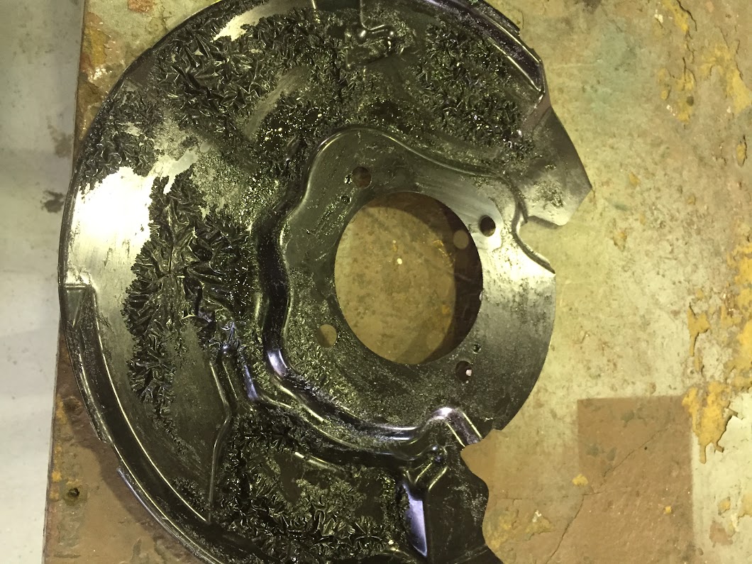

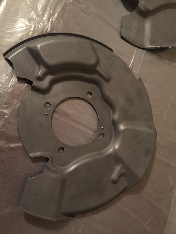

I ended up getting a new set of dust shields for the front brakes.
ZGUcmwQmo-trZoKz0BXuvte974bkn7rPS_ffru6Yoss=w597-h795-no
They were painted black, but I wanted to change them to a different color, so I stripped them.
P-EjtFaQ108IoJHIaZ3WMuWaXzy7OWFPaB0FsFrPrDA=w1060-h795-no
And then sand blasted them, and did a light sanding with 150 grit (as per the POR15 master - sanding after sandblasting, with a swipe or two of 120-180 grit knocks off the peaks which might be high enough to be taller than the POR15 layer - which in turn leads to a communication with the elements which leads to corrosion - the same principle as an air bubbles but in the opposite direction. Incidentally - to minimize air bubbles - you have to lay down the POR in very thin layers. But as air bubbles are inevitable in some ways when using a brush, you always lay down 2 layers of the POR base paint.)
nPAkPKIt0icX4Al_Fo7QuKgOXFn_hWkzKjubo7DLVoo=w597-h795-no
As soon as I have 6 hours to rub together, I'm going to be painting a few pieces their hopefully final colors. Six hours are necessary because the POR paint needs to be laid down in layers as they dry - with a slight drag to the paint without leaving anything on the finger - which takes 2-3 hours depending on the humidity per layer). I plan on doing 2 layers of the POR gloss black, and then the topcoat - or flex coat in the older terminology. Interestingly - and this doesn't have much bearing on parts that are under the vehicle - POR paint color degrades with exposure to UV light (I've heard varying reports on the paint itself degrading vs. just the color of the paint in UV light). In any case - the best results for pieces that will be out in the sun require the use of a topcoat that is not UV sensitive.

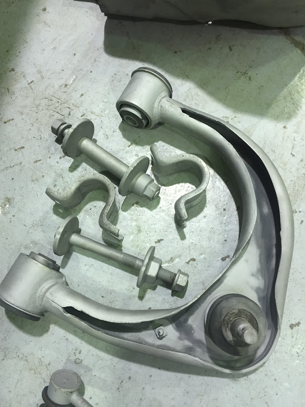

Not sure if I'll need new upper control arms. I don't have a good tool to extract the upper control arm bushings in the ones I've got now, and they are a huge pain in the ass to work with. I really hate to give up on stuff, but I'm thinking I might save myself some trouble and get some light racing UCA's (and also get myself a few more degrees to work with). I may end up going the total chaos route - but again, I'm not totally set. I was thinking about the camburg's as well, but not sure I can find a good line on them.

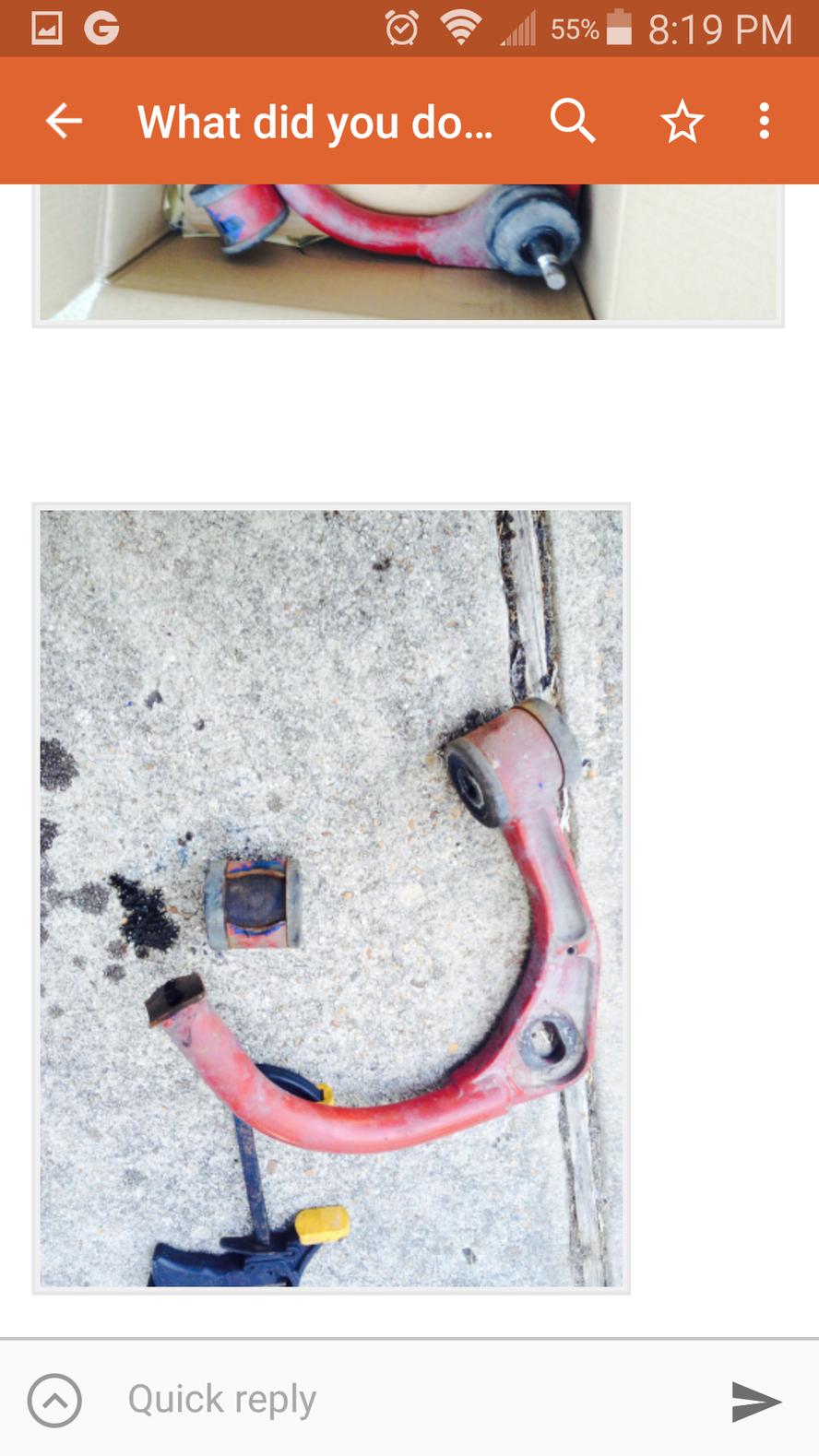

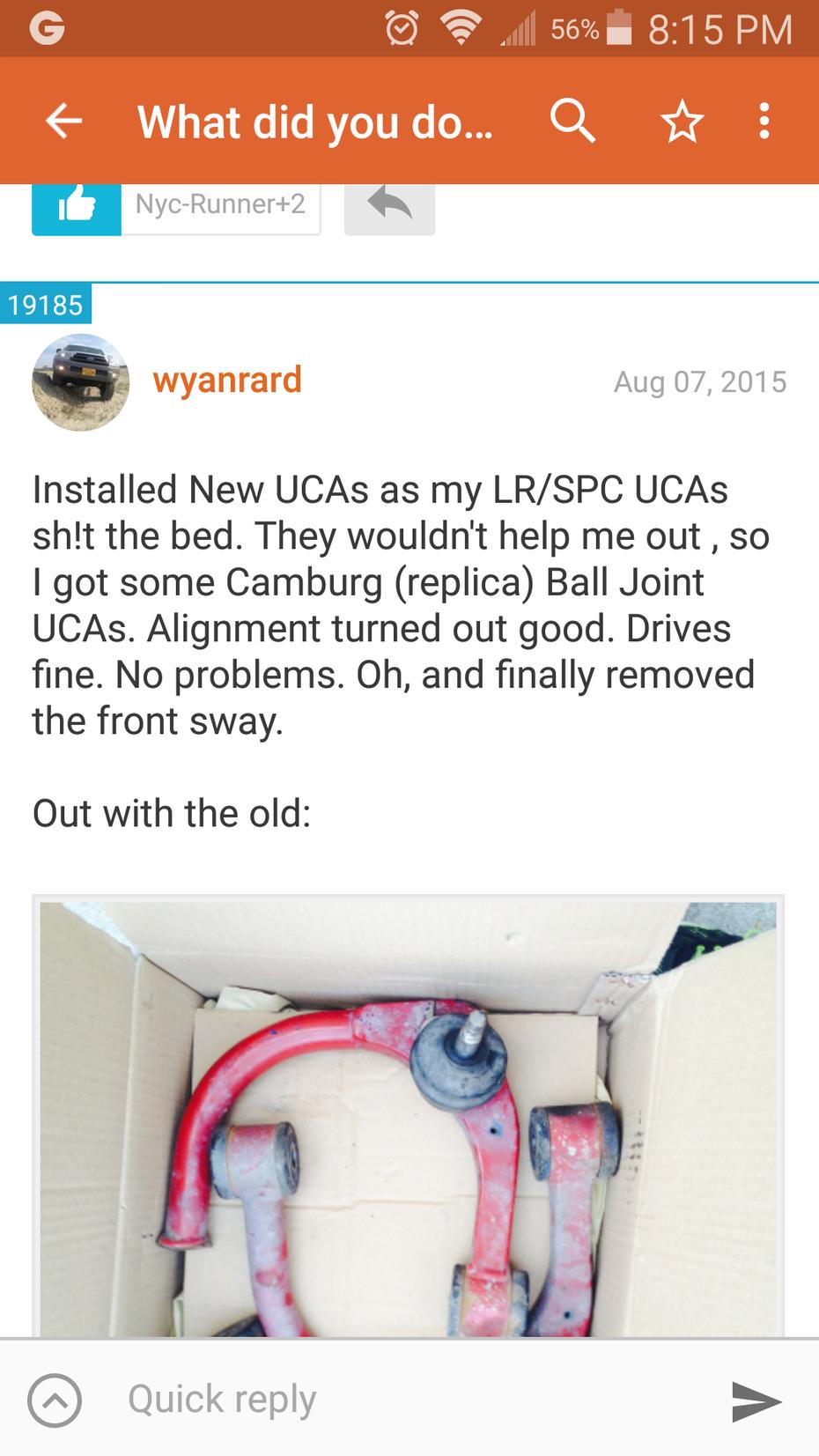

Im still on the fence about a body lift but everything is good so far. If i were in your shoes i would go ahead and get the UCAs, some people done mind not having then but it made my truck not very fun on the freeway. I siukd my light racing ones for the Camburgs....they are nice. Wheelers Offroad has some nice prices on their products.
Just a quick question if you don't mind LC2013 - why did you switch out to the camburgs? Were the light racing ones no good?
Well i went back and forth with the reviews some say they work great some nit....seeing this pic by wyanrard kind of sealed the deal for me....
