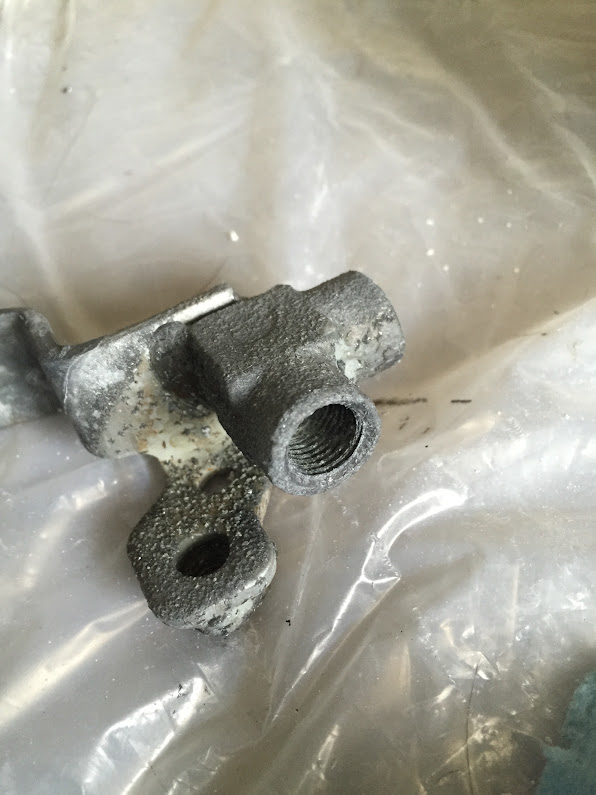

Some of the pieces I left in the overnight bath actually deposited some of the salt in solution onto the metal. I guess because I hadn't been judicious and had dissimilar metals in the same bath.... (dissimilar meaning more vs. less noble) and ended up with galvanic corrosion / salt deposition as would happen in a battery. Unfortunately I had a few hard to get parts in the bath, and now I've gotta find a supplier to replace them.
F3bPJOQrPIhczyZdVD2Kh_ucp93NaAstRbkGMXHIn8w=w597-h795-no
The salt is basically impossible to get off the female threads, so these pieces (brake line elbow female female) are now unusable.
TLDR: don't put dissimilar metals into an acid bath with sufficient salts in solution as would allow autocatalytic (not sure if that is the correct term here) salt deposition.

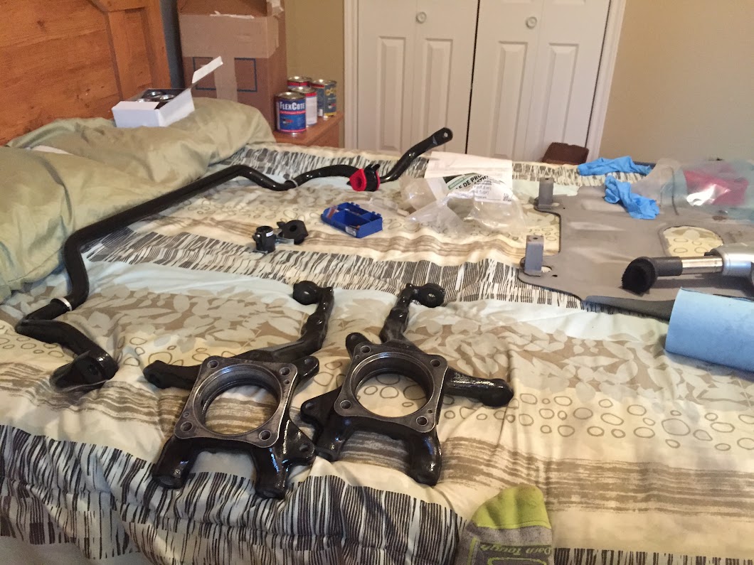

I've been painting the toyota pieces in the off time; which admittedly isn't much. Still - making some progress.
Mlb-5ekHCTpEJimyeWeGMITd9dB88WT_zAkEEzJ9CK4=w597-h795-no
Here is the brake covers, and the hangers for the brake lines and ABS sensor lines. I ended up going with the aluminium grey, which although being a bit more difficult to work with seems to hold its consistency much better than the metal mask. I didn't paint the contact surfaces of the dust covers - because the aluminium engine paint is nowhere near as hard as as the rust protection paint. Anything that is under a higher compression load - I either left without paint (as for ball joints and castle nuts) - or with a very light stain with the rust protection paint.
sFri8o-CR7LFGgRad47KmUr0Kwr7bWPKVvd-mS1wcrY=w597-h795-no
Mock-up fitting on the spindles - they fit very snug :) I need obviously to put the dust covers in place. I'll leave the final torquing until I've got everything installed on the vehicle. You can also see the first coat on the skid plates beneath.
