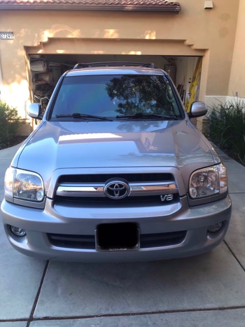

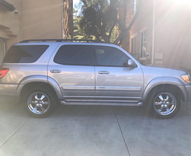

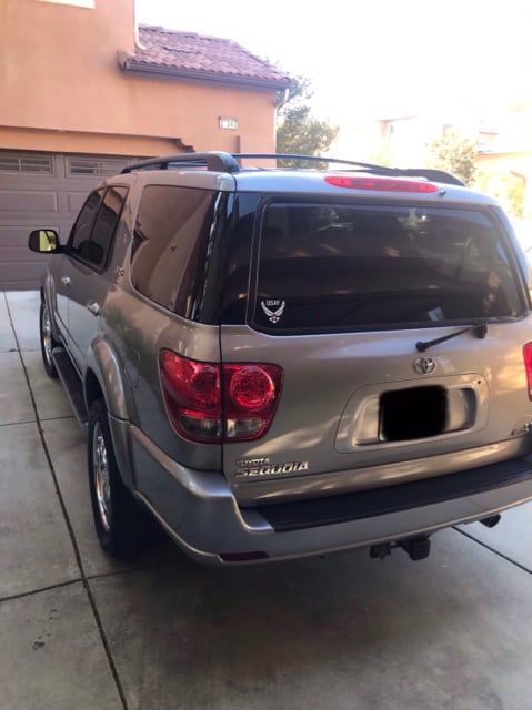

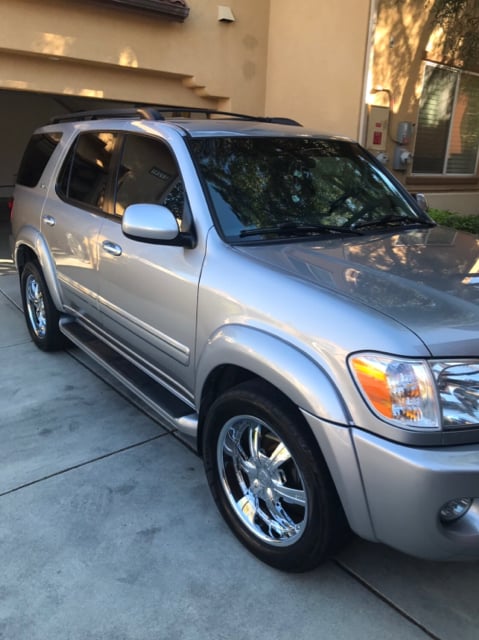

I know this is kind of late, but anyone try out Duragloss products? I've just used it recently w/ my 4runner and my wife's Sequoia and it turned out great.
These are the products I used w/ a Griot's DA polisher.
16 oz. - Marine & RV Polish
Total Performance Polish)
Clear Coat Polish)
Polish Bonding Agent)
Aquawax)
I interchange between the 501 and 105 as far as my polisher and I mix it w/ the PBA (polishing bonding agent) on a 4:1 ratio mix of 4 parts either 501 or 105 to 1 part PBA.
Next I'll mix in another separate bottle a 4:1 ratio of 101 CCP (clear coat polish) and PBA to give it that wet look.
Last step is to top it off w/ their spray wax Aquawax and I'll use that in between washes to clean my vehicle.
I also have Collinite #845 and will try using that this fall/winter along w/ my Duragloss.
This was a few months ago when I detailed her Sequoia. Took me three days to complete about 7-8 hours a day. Her car hasn’t been detailed in over 4-5 years let alone waxed.
I also used the 105/PBA mix to shine up her rims and glad to say, the brake dust hasn’t stuck as much to the rims compared to just washing and drying it.
I also used that same mix to polish the windshield and the rest of the windows and it worked well. It helped bead the water and expel it while driving, kind of like RainX
