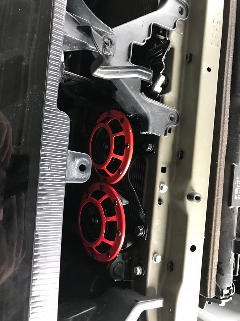

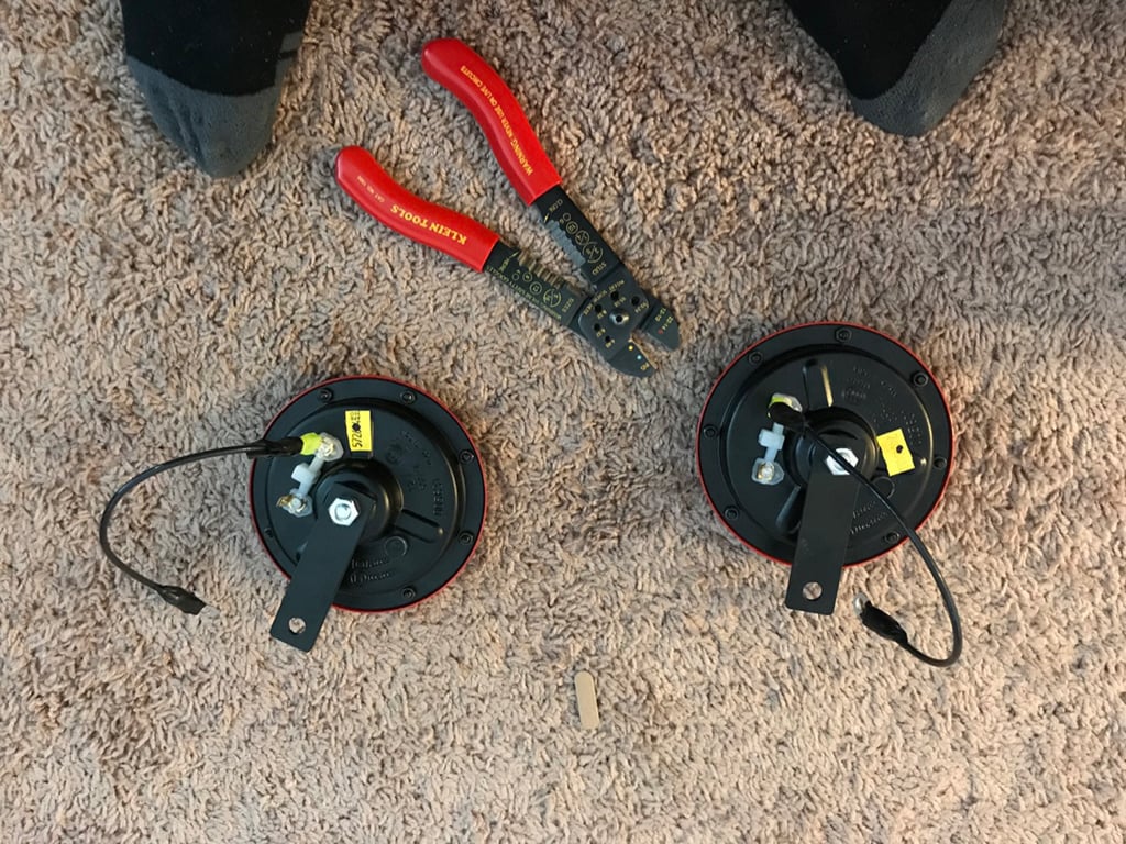

I wired my HELLA horns in using the factory wires, rather than run a new relay and fuse/switch, but they were really just plug and play. I did cut some plastic piece so that they would fit better. I got the red ones and the tone reminds me of the old school BMW horn.
Part way done with the wiring
Installed
