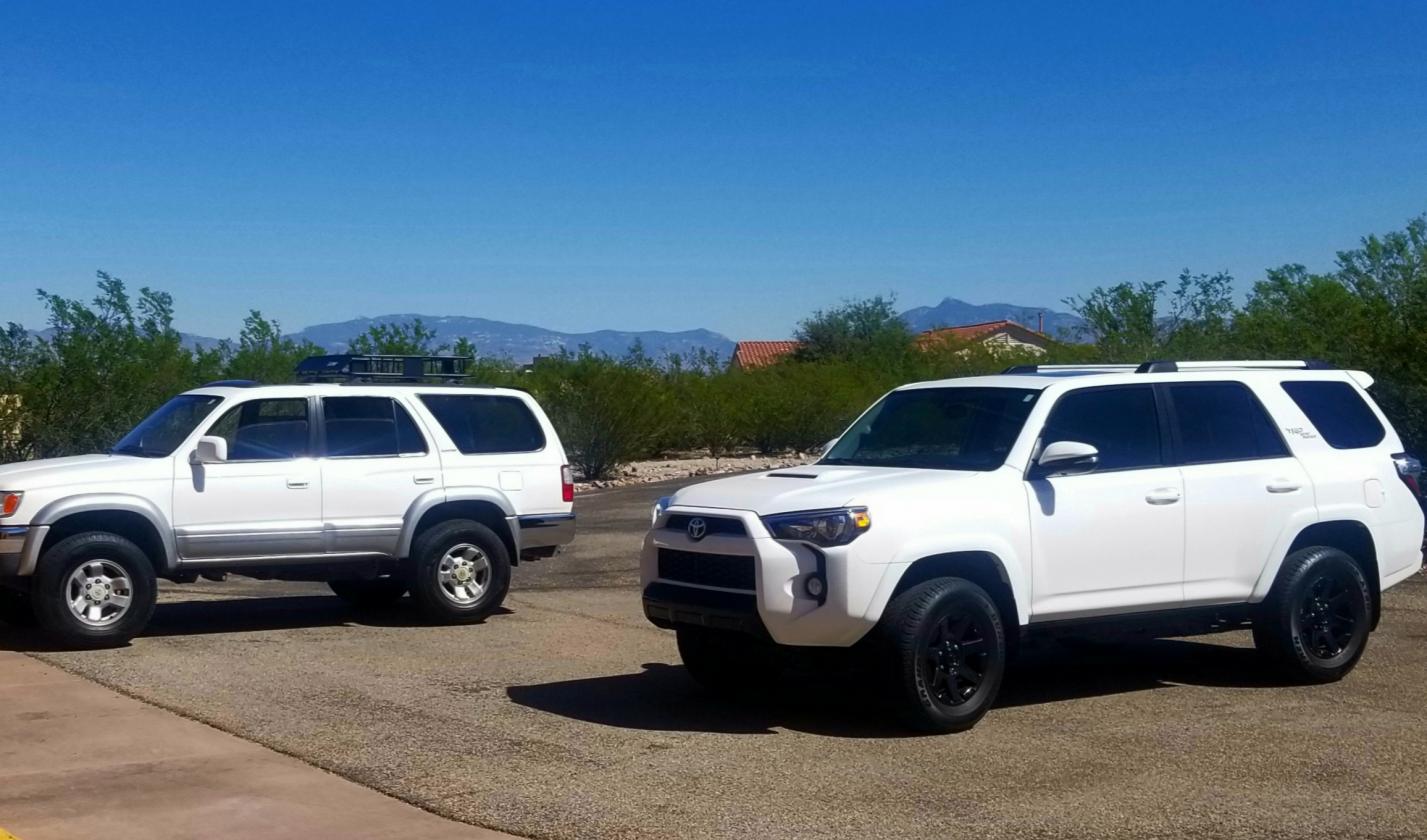

I have a 3 rd gen 4 runner which I've now had for years. It has been through 3 sons and my brother and survived. Now that I did on the big maintenance on it I want to turn it into an overlander. The problem is that after a 1500 mile trip from Tucson and through California and back I realized that with all the added weight the power and fuel economy sucks big time. The truck for years has been driven around tucson which is flat and power is not a big deal. It avg around 18 to 20 mpg . Driving to San Diego I think I got 14 mpg and it was tough to run 75 mph in the wind and up the slight incline on the 8. What is it that you 3rd gen overlanders or offroaders are doing to handle this power fuel issue on this 190 hp vehicle? I seriously am thinking bout either just using my 2019 Trd forerunner for my overlander or turbo charging the 96. I like the idea of adding a turbo but I definitely want to maintain the reliability of the vehicle since having issues a 1000 miles from home sucks.
