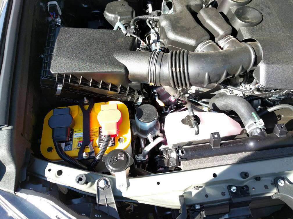

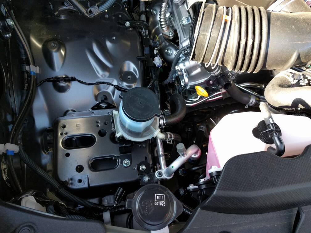

That's the air injection pump (located right behind the PS headlight). uploadfromtaptalk1463861418678.jpg I recently finished a dual battery install on my 2016 which involved relocating this pump up towards the firewall. Unfortunately the attached pic was taken after removal, but now you'll know where to look.
The pump is a little more audible when killing the engine now, but a small trade-off for that second battery. You can see the pump at the top of the second picture. uploadfromtaptalk1463861409677.jpg
