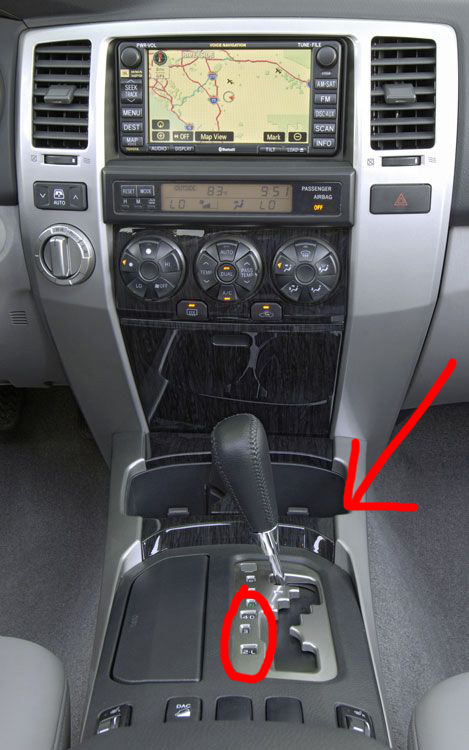

2) Almost every time I drive the area around the "2 - L" sticker in the shifter area gets really hot. All the way up to "D" and neutral and reverse gets hot. Eventually, spots (especially the "2 - L" sticker) become too hot to touch and will burn you. Sometimes it does not heat up at all. What is this and should I be worried?

I recently popped the compartment next to the shifter out, there's a lot of space under there, seems unlikely such localized heat is coming from the trans or engine. There are light bulbs under there, maybe those are getting too hot? Does it do this with the lights off?
I have a new to me 2003 4R Sport V6 and have noticed the same thing.
Gets very hot over 1 and 2 indicators, can't keep finger tip on it.
Cigarette lighter? heh
I hadn't noticed this on mine but the light for those indicators is right below the 1-2. I just switched mine to LED when I did the others in the interior (same bulb as glove box) so if thats the problem, I can't check it now. It only lights when parking lights are on so check & see if this occurs during the day.
