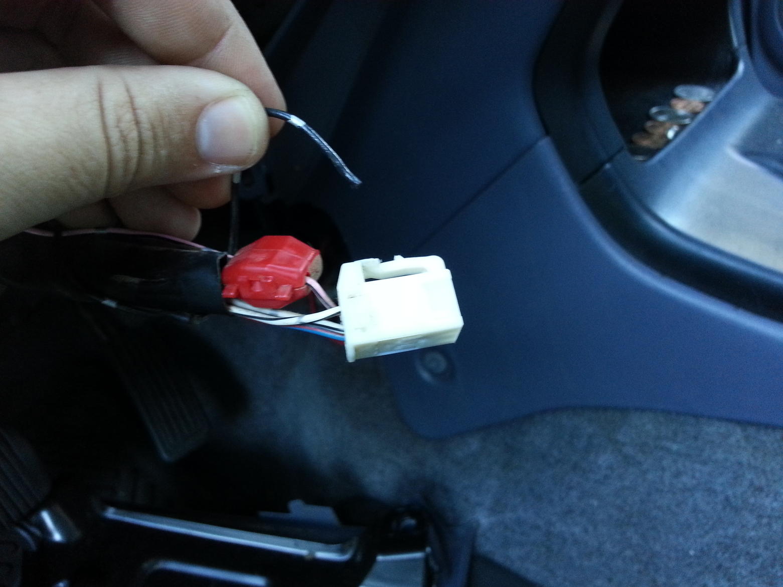

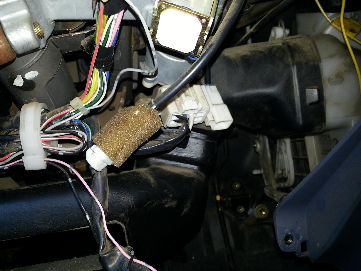

Well...still stuck and the first mechanic couldn't figure it out either. I was digging through the dash and I noticed a loose wire just kind of hanging out. It was wrapped around a 4 pin connector but it was not attached to one of the four pins, nor is the sheath at the end removed. Any ideas where it goes or what it's for?

If anybody else has this issue it is most likely the connector to your tail lights. Even though I didn't have a factory trailer harness to go wrong cleaning up the terminals and installing a trailer harness fixed my turn signal problem. My horn is still out so I have some digging to do, but this was my big concern. Here's the harness I bought for anyone else having this issue.
