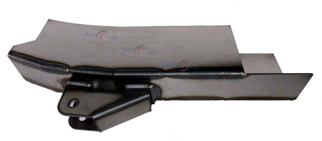

I would try to find a car shop/ welding shop thats experienced with frames to look at it and give you an estimate. If it is just a bad area for some reason, you may be able to do some rust prevention on the rest of the frame and repair the area and save the rest of it
SafeTCap(R) Kits - autorust.com
SAfe T cap is the product your thinking of, I believe
Post some pics if you can
4 Runner 2003-2009 4th Gen Archives - autorust.com
That's the exact route I am taking, thank you. The frame appears to be solid except for the two areas. My cousin has a welder big enough to weld in the caps. Should be good.
