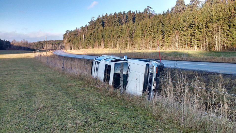

So there was some black ice and no spike tires and my wife slipped, did a 180 and ended up in the ditch backwards.
She was not going fast and there doesn't seem to be much damage, but when we wanted to pull the car out of the ditch I couldn't get it out of park.
Then I found out that if I pushed the 'shift lock overdrive' button I could move the stick. But only when I hold that button, as soon as I let go I cant't move it anymore and it will stay in park.
The car got towed out but then when I tried to start it, it just makes a big 'cluck' sound, as if the car is actually in gear; the starter comes out but can't turn the engine.
Any idea's on this one?
I really miss this car, now we all have to walk 20 minutes to get to our house.
(I tried adding a picture but that didn't seem to work; http://uploads.im/7rnDT.jpg)

With 4 runner on its side like that you probably have oil in the cylinders..!
Pull spark plugs and try to turn engine over by hand first..:thumb:
