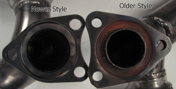

When I bought my JDM motor they had one with stainless manifolds and crossover pipe, though the pipe end looked to vary from what my 1998 had.
It looked like the one pictured in this thread. I don’t know what it comes in, or it’s flow characteristics, but it looked like it would flow better than what my 98 has.
Might be an option???

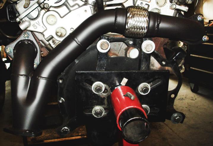

Me too. Offroad Solutions makes a sweet crossover pipe; but with left side collector for 5VZFE conversions into 2nd gens. See below. Wish they made a conventional right collector version...

All of the above; however, is after the stock OEM crossover pipe and its 3-bolt collector flange. I do have the later non-cast iron manifolds, which do breathe better at least. See below.
Fabricating a custom crossover pipe is beyond what I'm willing to consider unless I too, one day, go for DT headers.

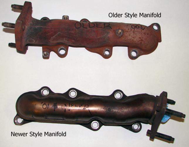

I like this, someone else who's actually thought it through from start to finish. You might even get an MPG bump from the increase airflow. Be sure to also open up the intake a bit, the stock intake is restrictive even on a stock engine. That's interesting about the manifolds as I recently discovered that as well. I've got two sets of manifolds, one from a 2000 with 2 cats and one from a 2001 with two cats and the 2001 is bigger with more flow. It's so odd that I couldn't even find the part number for it.

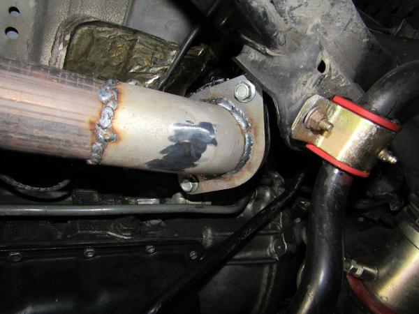

For the question on my exhaust, this is what it looks like just below the header collector:
The DT Header kit allows for cutting off the exhaust right before the cat as it relocates the oxygen sensor further upstream, all smog legal. You can see how the 2.5" is bigger than stock 2.4" piping. The guy who installed it didn't cut it all off so when I do get the full exhaust done I'd like them to either chop off all the remaining stock downpipe or replace the cat with a 2.5" in/out to match the headers. Then go 2.75 or 3.0" mandrel bent the rest of the way out.
You've piqued my interest. My 4R has a build date of 09/98. It surely has later exhaust manifolds i.e. not cast iron & w/o heat shields or their bolt bosses. That said, are either of the 2 sets of manifolds you possess cast iron?
To add to my confusion, I've now identified 3 sets of p/n's on Toyota's site for later 3rd gens: Left side only for illustration:
17142-62090-4WD AT SR5, 2000, 2001
17142-62100 - discontinued, superseded by -62110
17142-62110-4WD AT SR5, 2000, 2001, 2002
Note the application year overlap. I'd assumed that all non-cast iron ones - 99' Cali and onward, had larger output ports, mating to the single output crossover pipe for dual cats. Today I've seen pics of two types of non-cast manifolds - one with 3 separate flanges to mount to the head and one with a one-piece head mounting flange. If their port sizes are different, you'd think that there would also be two different corresponding crossover pipes to mate with. Can't find any evidence of that.

Yes, one pair is the older cast iron and the other is not. Cast iron are definitely smaller and more narrow. Can confirm the crossover pipe is also wider on the non-cast iron crossover pipe. It's much thicker and wider than my old 98 one. However, before anyone gets too excited about these, it's the collectors and individual exhaust runners that gain the power on headers for our 4Runners. The exhaust manifolds do a poor job of allowing exhaust gases to pass as the exhaust valves open and close and the stock collectors are pretty restrictive.

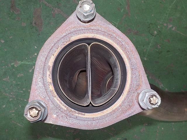

Agreed, I think the later stock dual-cat crossover pipe collector is the worst offender:
