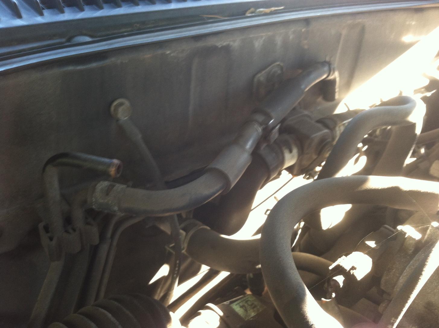

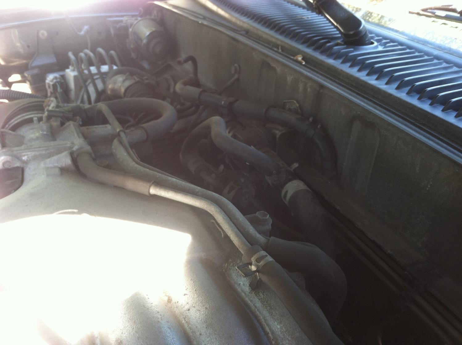

I recently acquired a 98 limited and opened the hood to check some things and noticed it looked like I had some disconnected or missing vacuum lines. The are two small ports on the throttle body, one open line to the left of throttle body along the fire wall and one disconnected along the firewall closer to the master cylinder. Please help!

Just ran out and looked at mine. The two ports on top of the throttle body are capped on mine. The hard line in the left side of your picture goes to a t-fitting in one of the heater hoses. I didn't notice the other one by the master cylinder. Sorry for the vagueness.

Those are your auxillery heater lines. It must have kleaked on your 4runner and instead of fixing it, they unhooked it and bypassed it.
Nothing to do with emmissions.
x2. Those are where your rear heater lines should be. If you look under the passenger side you'll see a couple metal tubes running along frame the rail. Chances are yours rusted through, and rather than replacing them the PO just got rid of the rear heat.

The ones in the pic feed the rear heater, as others have said.
I have done the same to mine with the lines because the rear heater lines are rotted and honestly, the 4runner interior isn't big so the vents from front heat up the rear/whole car pretty quickly. It's basicslly by passed ... Nothing to worry.
