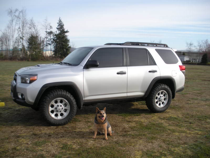

How about these Toyo open country MTs. I hear they are great on road and killer off. Very low noise is the rumor. and look sick.
btw not my truck. Hope owner doesn't mind me posting.
