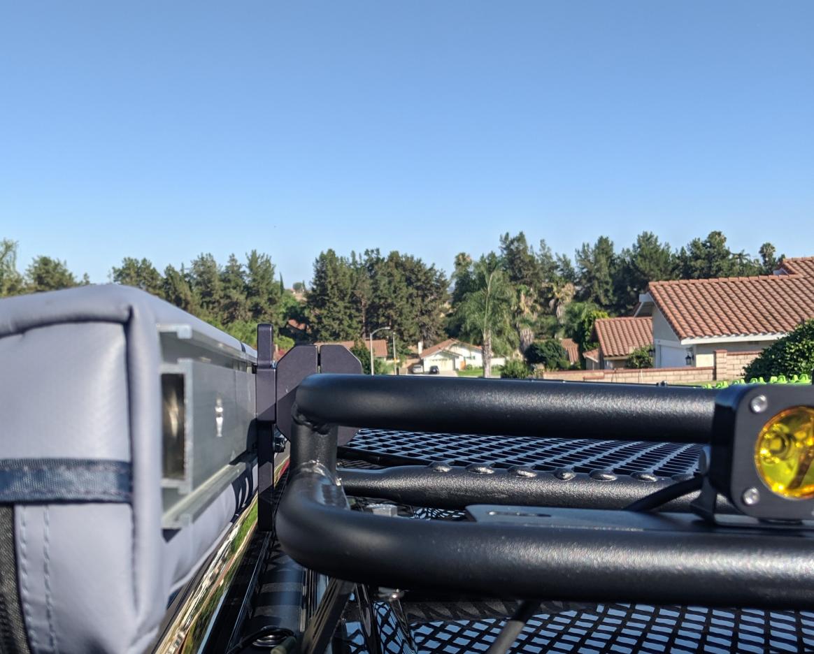

I used the gzila mounts too. The actual awning sits pretty flush with the rack, but the brackets have an extra inch that sticks up above the awning. It’s kind of annoying. I reached out to see if he could make them without the extra inch and mounting hole, no response. If I flip the bracket over, it would hit the paint or the awning wouldn’t be sitting right
Edit: I just noticed you asked about mounting to a Gobi, I’m issuing a Baja flat rack. You can use the same mounts, flip them upside down so there is no additional stocking up, and mount them to the top bar on the rack

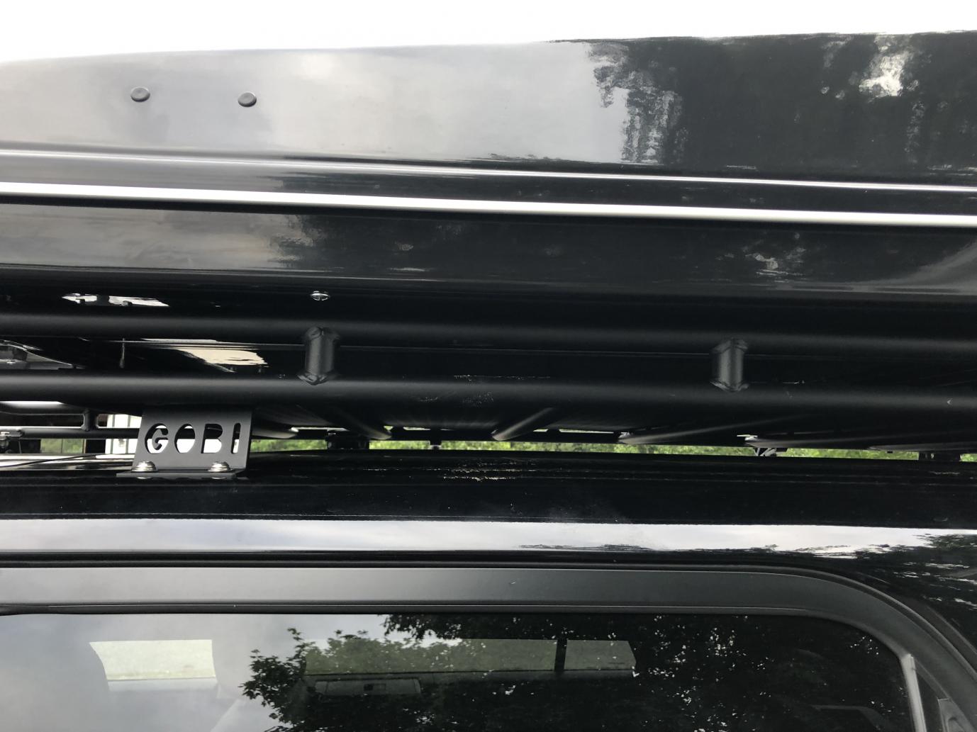

Main concern is my stealth has a RTT on top (Small Grand Tour by autohome). I need a mount that is low profile like the gobi mount so it doesn’t touch the RTT on the top tube, or I think I need to find a way to mount to the bottom tube of the gobi. Any ideas?

Not sure how much clearance you need for your RTT, but here's a picture of my 2500 mounted with the gzila brackets. Maybe you could flip them and mount on the lower tube?

Hi Dillahnski, Thanks so mush for posting the pic of the Gzila I have been in touch with them and trying to figure out if mounting on the lower tube will work. In your pic do you know how much the bracket sits above the tube? It looks to be about 1/2 in which I think would work in my set up. Here are a few pics to show the clearance and the space between the tubes
