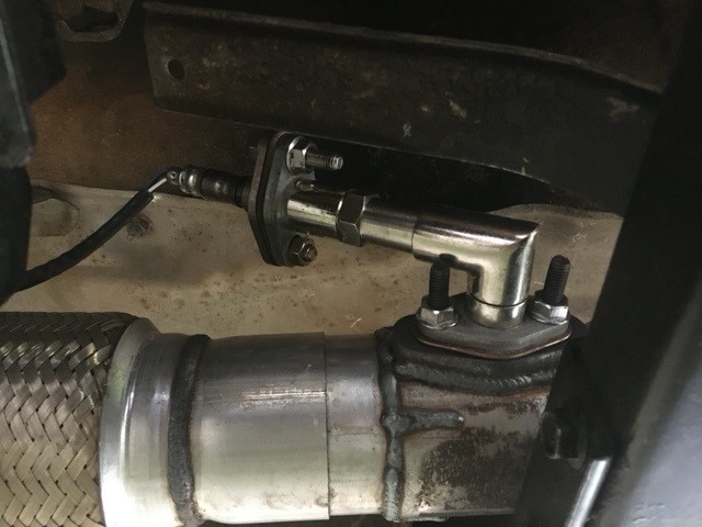

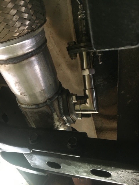

When I installed the turbo, it eliminated both of my cats. I used a spacer that has the Toyota 2-bolt flange, and it has eliminated my P0420 code. Only place I’ve found this particular spacer is on Ali Express. Since its sole purpose is to fool emissions checks on the vehicle, I don’t think it’s allowed on eBay or Amazon. Just search for Toyota Oxygen Sensor Adapter on Ali Express, took about 2 weeks to get here from China.
Thank you for that, I have actually been looking for something to cheat the 02 sensor but I couldn’t find anything. I’ve also been curious about eliminating my cats completely as well. I’ve read mixed reviews on removing them. But you have been happy so far without the cats? No issues you’ve noticed from eliminating them?
I've not had any adverse issues. I also eliminated because the downpipe and midpipe that came with the CX Racing turbo kit didn't mate up to the California-style emissions, 2 catalytic converter setup I had from the factory. So I just replaced from mid pipe to the muffler inlet, and have a flex pipe instead of a catalytic converter.

You should do a Toyota Time video showing installing this sensor spacer and your results lol. It's permanently killed the P0420 code for me. Unless YouTube objects to videos showing circumventing emissions controls?
