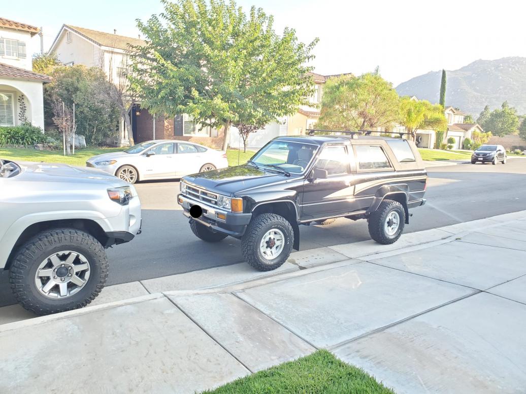

Ha, that was me, down there for the car show. Picked up the 1st Gen a few months ago and have been doing an OEM resto on it. I have yet to post here but plan to, so far have just posted for my 5th gen on this forum.

Nice truck! Looks like it's all there which is not always the case. I'm guessing you noticed my thrashed rig. In July it was stolen and they took it wheeling at the lake. Got it back 3 days later minus the winch, front bumper, wasted the hood, valance, passenger door and rocker panel including the trim. It could have been worse I did get it back and it runs as good as it did before they stole it.
Have fun with yours!

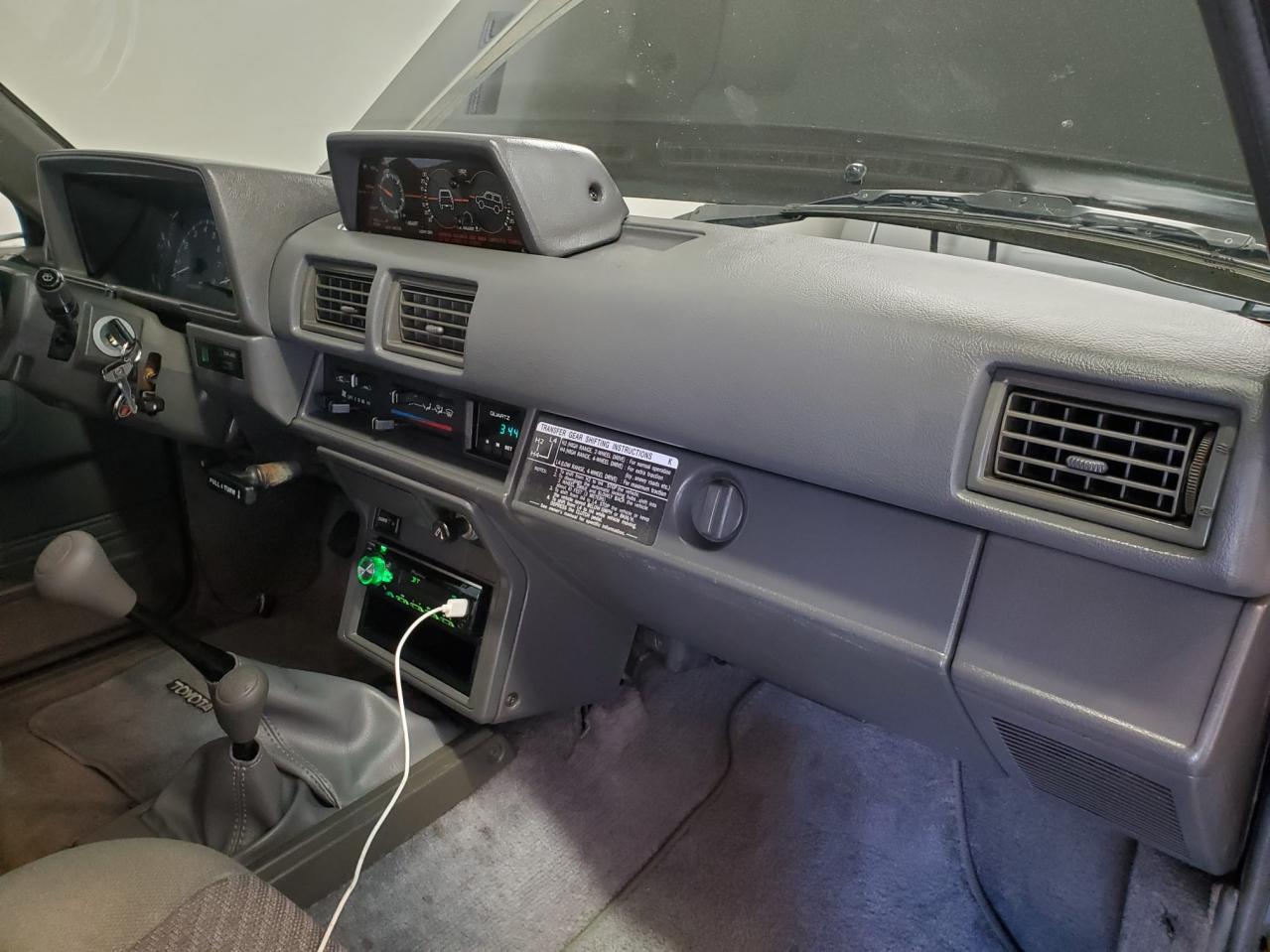

Replaced cracked dash with a almost perfect one I scored on YotaTrader, and added Clinometer, after all is a 1st Gen really a 1st Gen without a Clinometer???

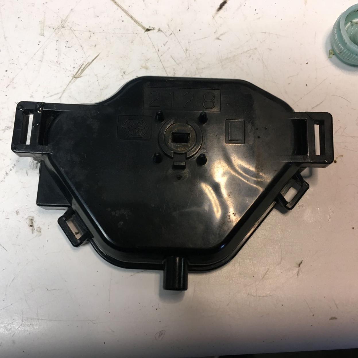

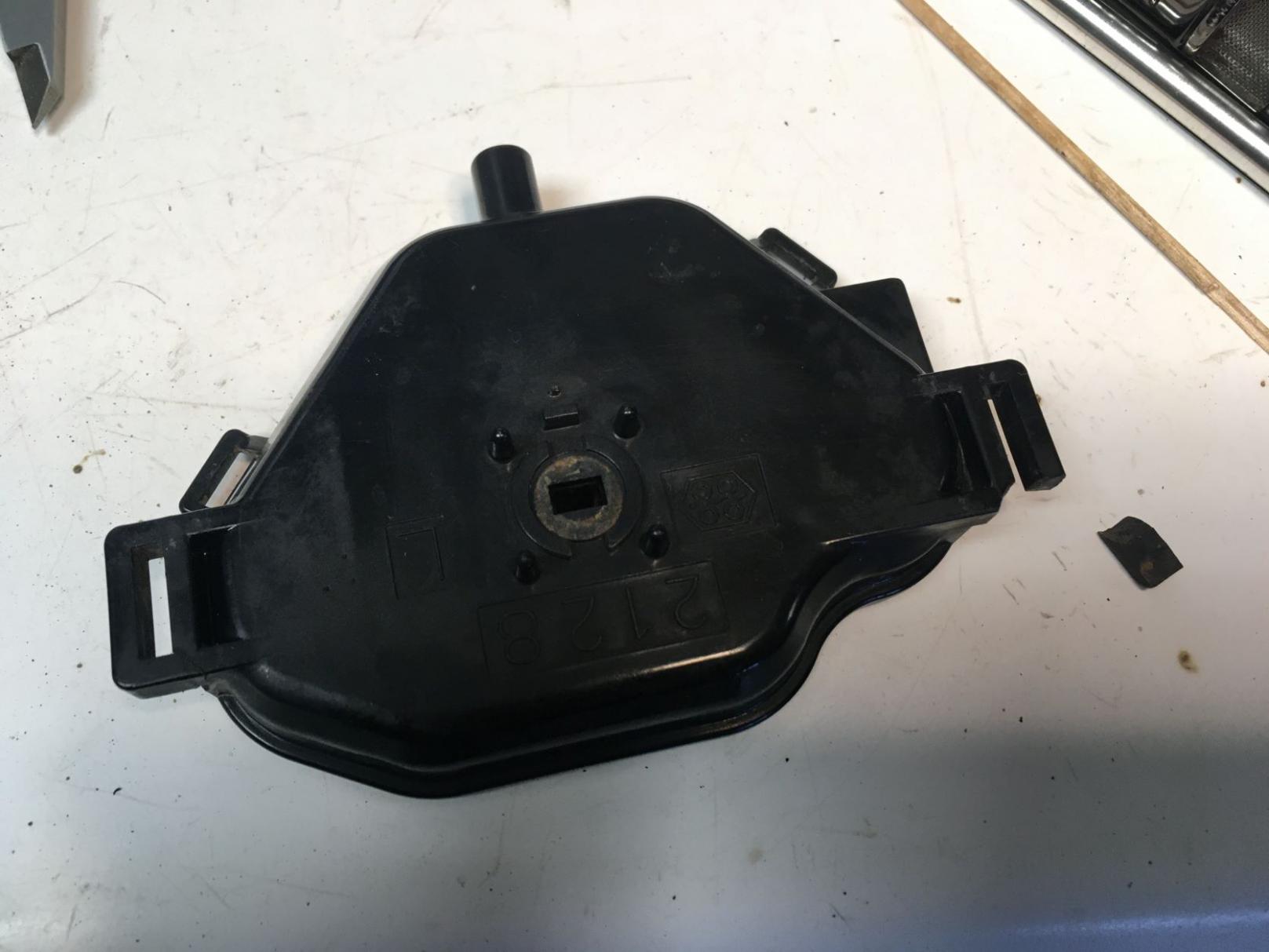

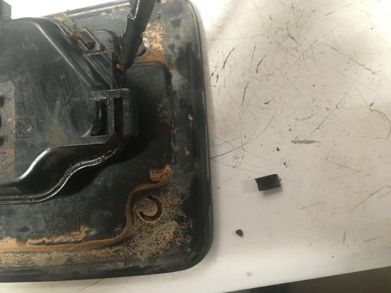

Power mirror
I repaired my power mirror. Was lucky enough to still have the small piece that broke off of the housing. Disassembled bonded the broken mount and once again good to go.

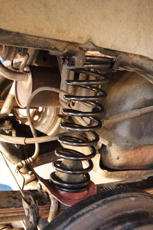

...They do squeak even after I sprayed them down with silicone lube.

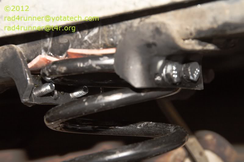

Could it be that when the spring compresses it rubs against the corners of the upper bump-stop?
I used straight springs (new Black Magic Springs so they cost more) on mine in 2012, cut off the upper bump-stops and installed capture screws. No squeaks, no issues and rides very well. Write-up is on Yotatech here: RAD4Runner's 1986 4Runner dlx Build-up - Page 5 - YotaTech Forums

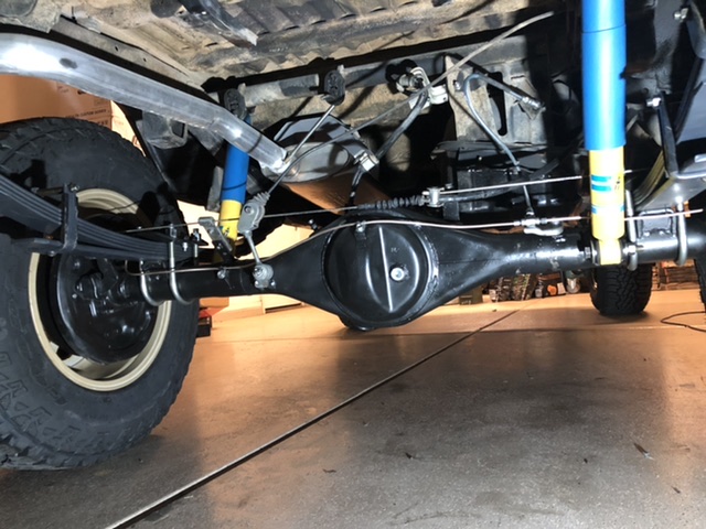

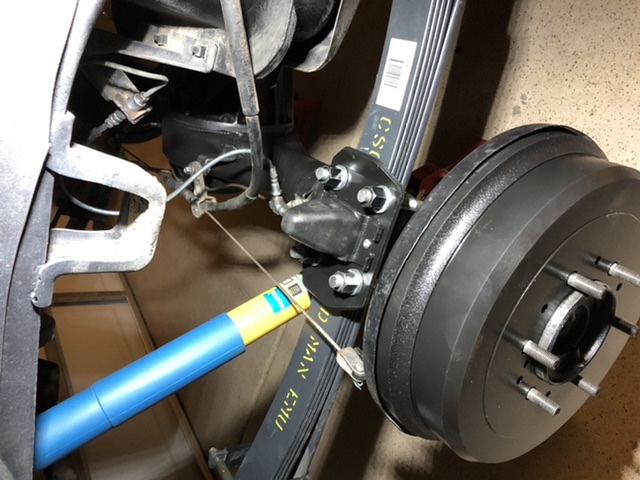

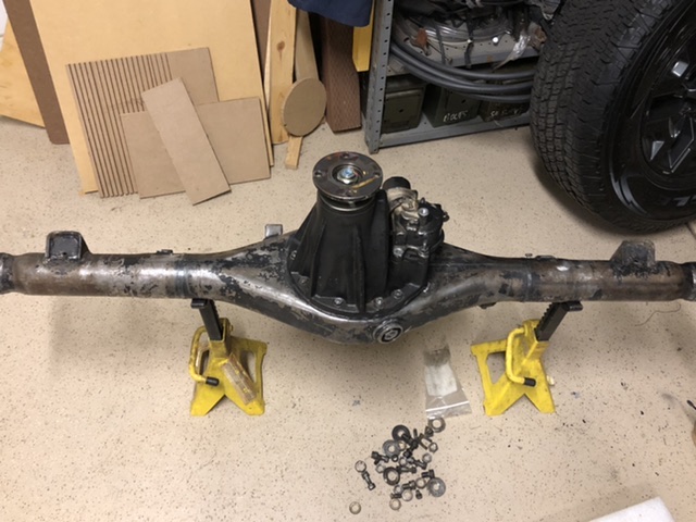

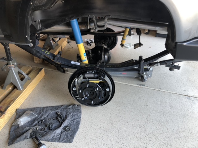

Complete rear axle rebuild and elocker retrofit. Even made some brand new brake lines from raw tubing.
