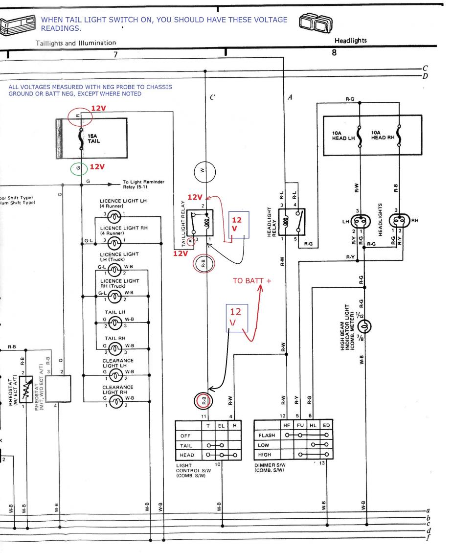

I ripped my 86 apart trying to find the short thats causing my dash light and tail lights to be non-op. It’s not the fuse, the dimmer, the relay, corrosion on the bulbs or the trailer hook-up(I don’t have one but I read that was a cause so I look for it.)
I’m stumped and annoyed.
That sucks. Sounds more like an open than a short. Curious about your method of testing and whether or not you have a wiring diagram on hand. That system should be pretty straightforward for finding where the power or ground is vanishing.
You would think. My not very savvy when it comes to electrical. From the time I first posted to now I found a proper FSM wiring diagram.
Yet I’m still battling this issue. I get power to the tail light relay, the headlight switch will send power to the fuse. , however once that happens it pops the fuse. I’ve tried isolating the issues by disconnecting everthing that comes off that fuse. Custer lights, taillights, light reminder (buzzer), cruise control switch, the damn clock and all other dash lights...it still pops the fuse the moment power is applied.... I’m pretty stuck...my last guess is something forward of the relay..or..maybe I’m getting to much power some how.
I ripped my 86 apart trying to find the short thats causing my dash light and tail lights to be non-op. .
How di u make sure it's not the fuse, the dimmer, etc? Got multimeter?
