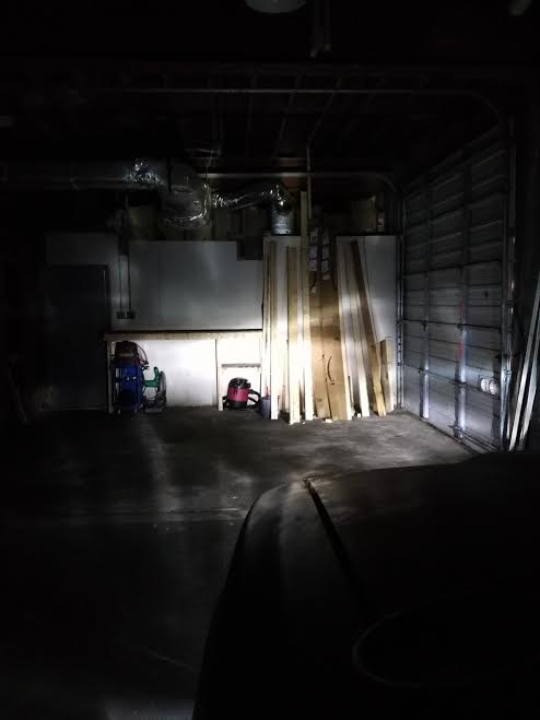

Yeah I'll sleep on pulling the resistor's. They work great right now, can still see them from out in front of the truck with the lights on. And here is the picture of how they look on, its about 20-25 feet to that wall.
THanks, but i wanted to see it from the front with just the LEDs on. Sorry
