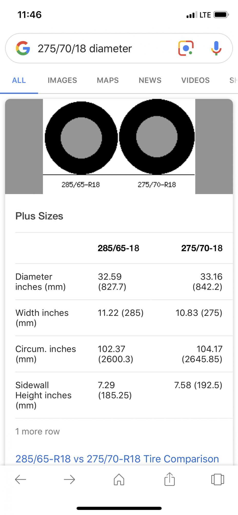

275/70/r18 is a 33”+ tire I am pretty sure you may need a body mount chop. I have 33” tires on my 20” wheels and I had to do body mount chop and also remove mud flap, carve off some of fender, and push liner forward. Also added a considerable amount of lift 3.5” or so in the front. 4th gen has the smallest space for large wheels of all generations it seems..
I may have carved a little extra to be on the safe side, because immediately after installing the 33” tire even with the lift it rubbed terribly with the 33” tires not even driveable to even be reasonable to do any medium to sharp turning without rubbing terribly and making a horrible sound. (Before body mount chop)
The rear won’t need much work at all, mine rarely rubs if I turn into a driveway and drive the rear tire over a curb while turning fast it’ll heit the rear mudflap very briefly but not under normal street conditions, I do plan on leaving the mud flap in but putting in a flat screw cus I don’t mind the rubbing on the plastic but I’m worried the bolt style screw that screws the mudflap in will start chunking off pieces my tire of it does rub often enough.
