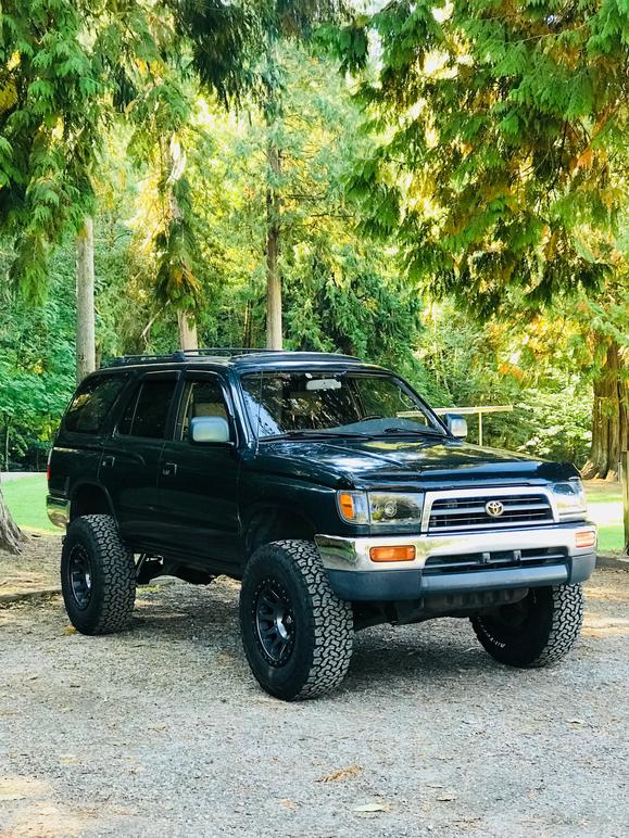

I am running almost the exact same setup except for the rear springs, but upfront I do rub a full lock only when flexing out of my driveway.
Wheels 17x9 -12 offset.
Tires LT285/70r17 BFG ko2.
What springs do you have in the rear??? Your ride looks clean
891s will sag under the weight of a loaded CBI bumper. I upgraded to 861 from 891 due to my CBI. Took less then 2 months, if I remember correctly.
