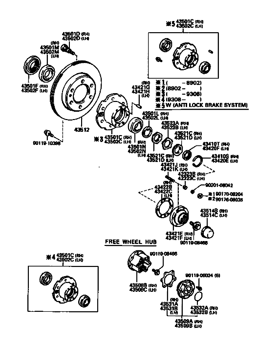

That bolt and washer are the secondary part that retains the stub shaft of the axle assembly. It, in concert with the thrust shim and clip stop the shaft from moving in and out too much while the suspension cycles. Some people (believe) you can either simply run this without the shim and clip or just simply run a shim and clip. It was designed to be ran together. Here's a basic diagram, somewhere on the web I have the full pics/etc. (ih8mud IIRC??) Make sure you got the proper thrust washer and clip. If they're not there, run 'em.
That bolt is just used to help locate the axle shaft when rebuilding/overhauling the axle assy. It serves no other purpose.
Awesome thanks for the response guys! I just wanted to make sure I could get it to the shop tomorrow. That washer on there is just as wide as the axle end. I didn't see the point of it, but it's there for a reason. I'm not going offroad tonight so I'll be fine. Thanks again for the input!
