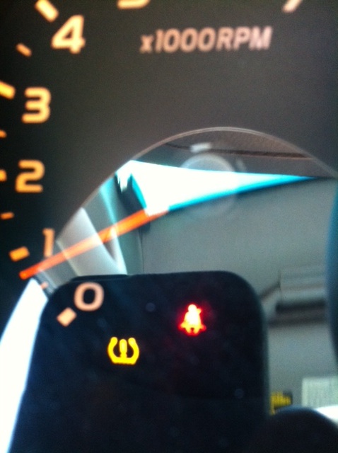

Hey yall, i am just looking for some help. I just had this yellow light turn on when i turned my car on today. I was wondering what it means and what i should do.
Thanks! -Joe
Edit; I forgot the picture. Haha one moment and ill upload it.
here she is.
awesome, so thats just low tire pressure?
Yes my friend, that symbol is for low tire pressure(flat tire, puncture, etc..) , but, and don't quote me on this, I think could also mean problems with the tire valve sensors. But mainly is just low tire pressure!
Hope this helps!
The TPMS icon comes on when tire pressure is below about 26 PSI on any one of the 5 (yes, five) tires so don't forget to check the spare. If the icon blinks for 1 minute and then goes solid after starting the car, then one of the sensors has failed OR your spare is missing (as was the case for me when I went to Chicago last December after some azz wipe stole my spare).

What he said... I have same issue, was the spare tire being low.
