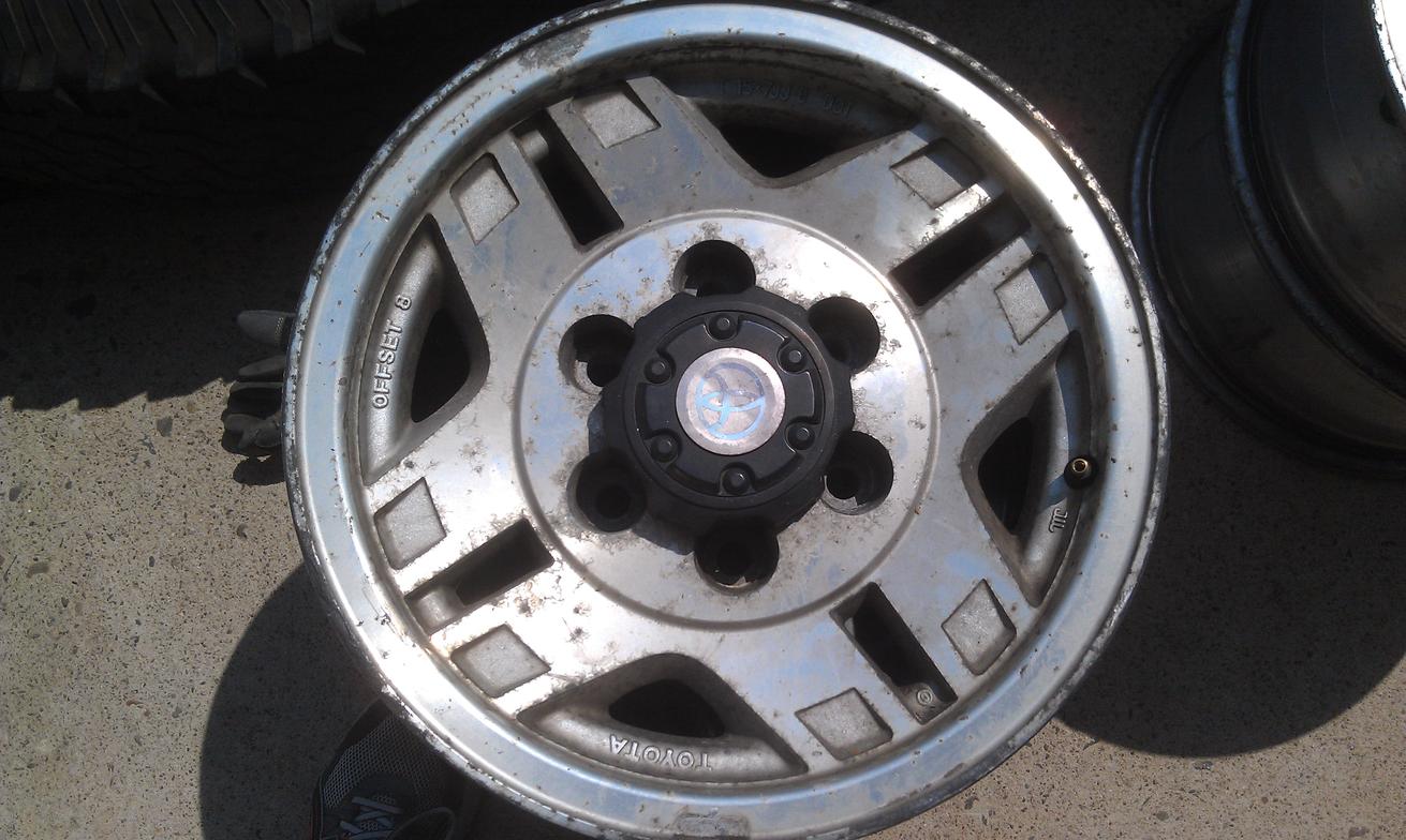

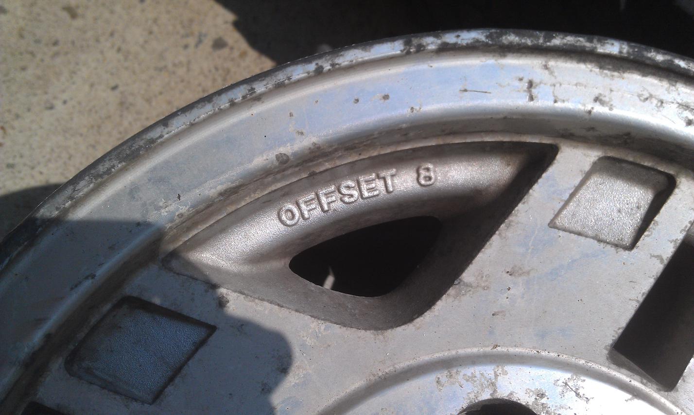

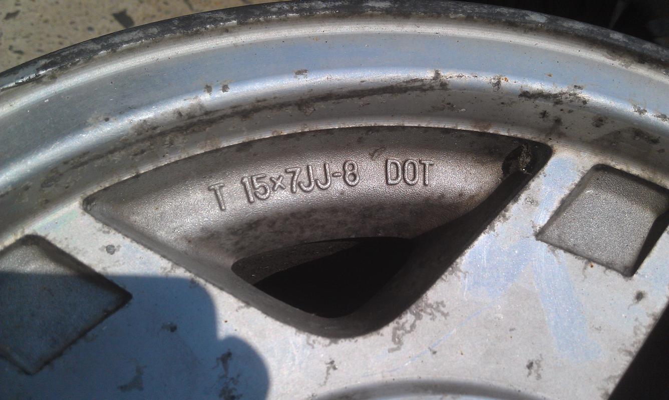

Here are the pics of the rims. Any ideas on what gen? Thanks

I dunno about 1st gen, but those are also stock on 2nd gen 4runners.
The bolt pattern is 6x5.5 for toyota, chevy/GMC 4wd, nissan, and some full size jeeps (wagoneers for certain)
Yep, Those are the SR5 wheels from the mid 80's thru 1995. Almost every 2nd Gen 4Runner you see probably came with those stock. They also came out on 1991 -1992 FJ80 Land Cruisers.
I'm not sure what aluminum is going for but I would say if they all look like that one then $50 - $100 for the set of 4 wouldn't be out of the question, depending on what your market is.
pattern is 6 on 5.5 as stated above, but the center bore is different and the lug nuts that come off the Jeep won't work on a Toyota. 7/16" vs 12 mm
I've seen sets in poor shape go for as high as $150, I wouldn't scrap them. There's enough guys doing semi-restorations on these older trucks that you shouldn't have much trouble finding a buyer.

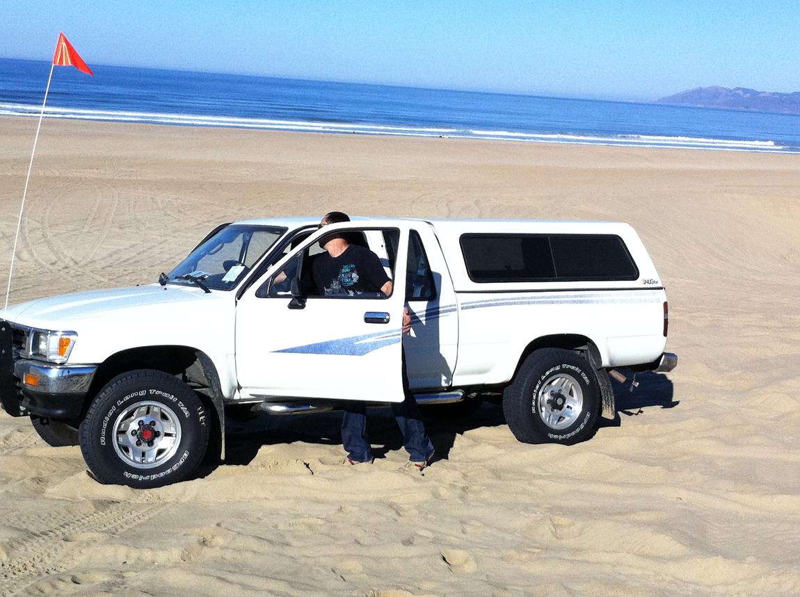

They came out around 86 or 87 4runners and SR5 trucks and could be seen all the way to 95.the one that came on the Landcruisers are offset 10 and only showed up till 93 IMO.Here is a pic mounted on my 93 hilux.
