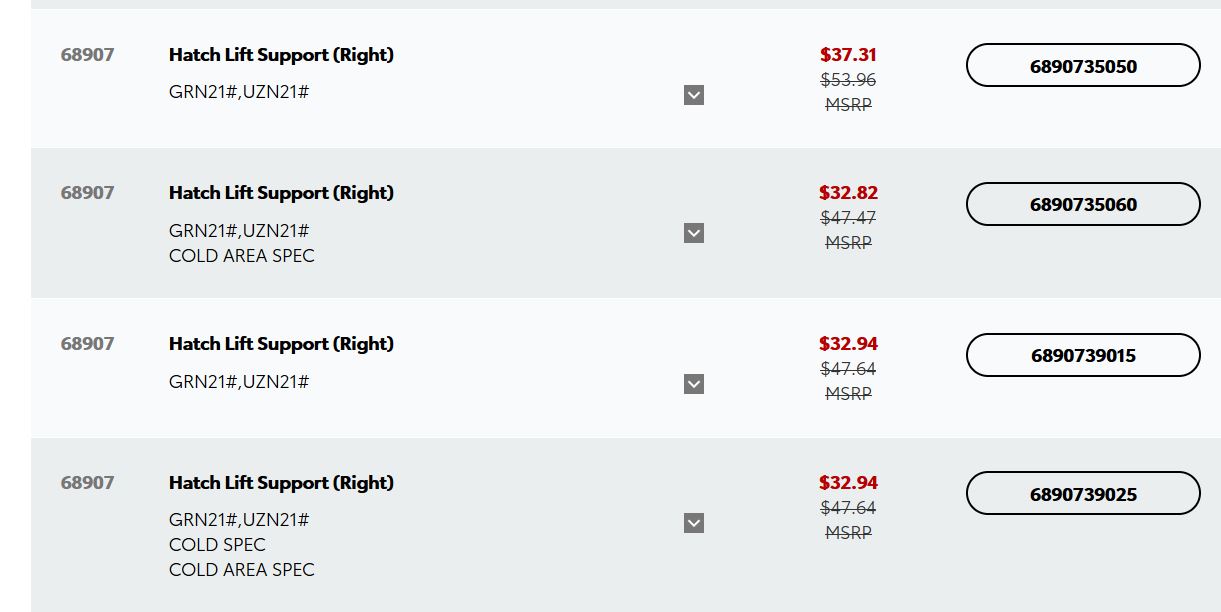

For anyone following this, the lift struts arrived today, 15 minute installation. You will need new pivot bolts unless you know a trick I do not - for my 03 the part number is 68961-35050 and you obviously need 2. I'm sure there is some trick to getting the old ones to release but I couldn't find it and everything I read said you need new pivot bolts. All the bolts had a lot of loctite on them and the new pivot bolts came pre-treated with threadlock and I added new Loctite to the upper bolts.

Anyone figure out the difference between the 4 rear hatch struts.
My right side is looking like its about done.
