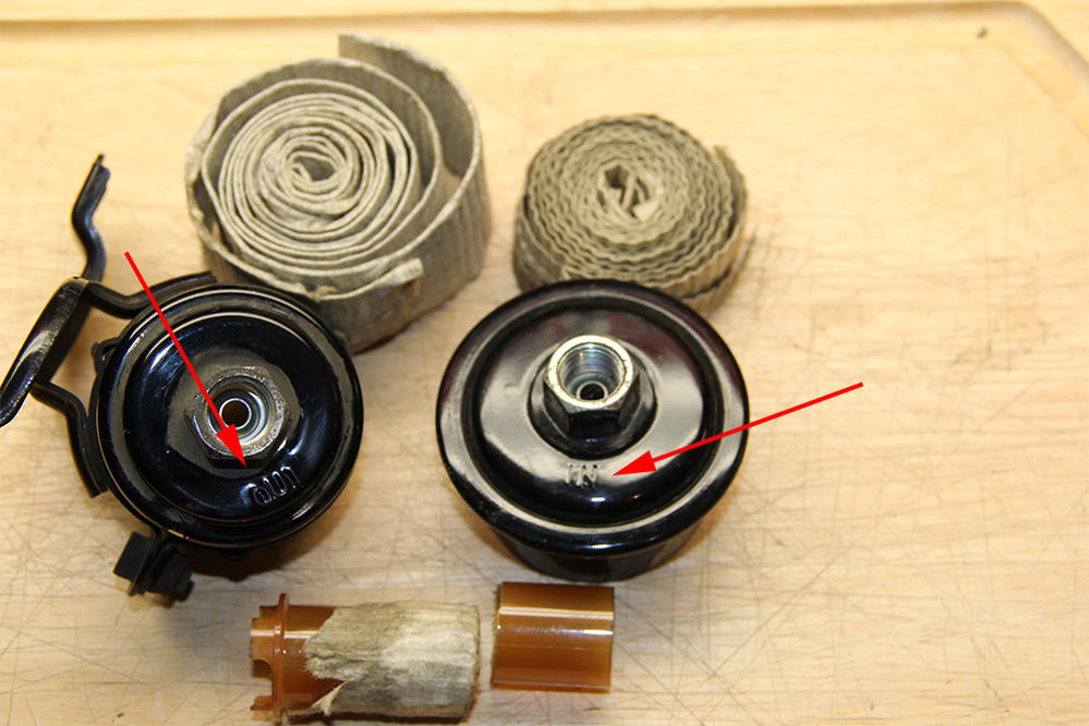

I dissected a filter if you want to see what it looks like inside. The link is that thread.

Photo of dissected Fuel filter
The filter is marked with IN and OUT. From what it looks like you're fuel flow won't be as efficient (a bit more restrictive) and the fuel won't won't be filtered the way it's intended to before heading to your engine. As [MENTION=115020]ThorInc[/MENTION] said - Just swap it around.
