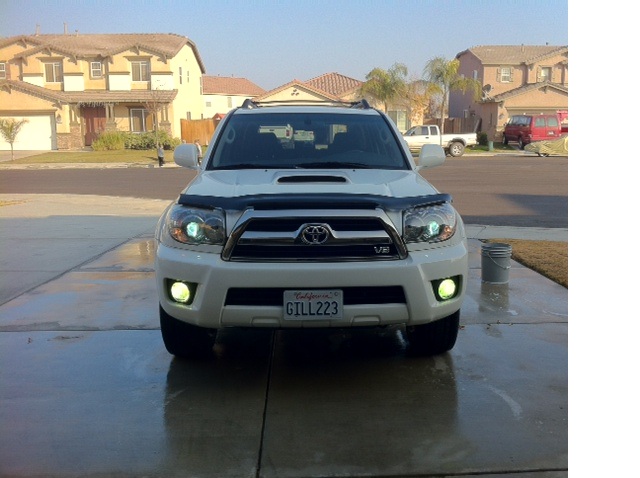

Xtreme Depot 6500k low beams and 3000k fogs

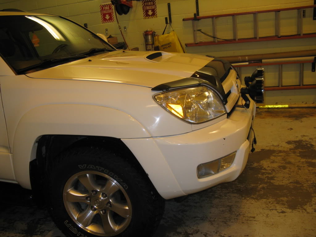

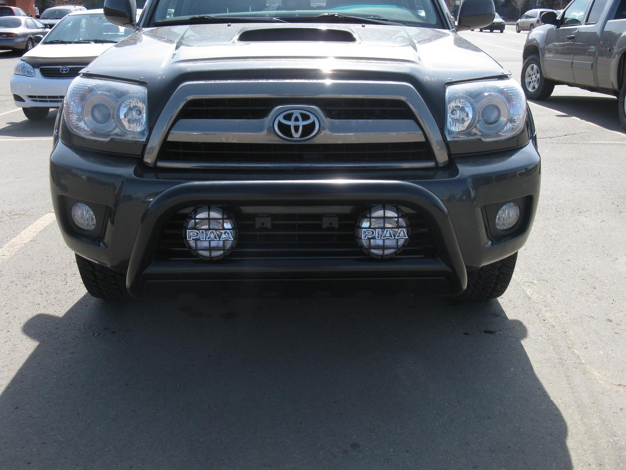

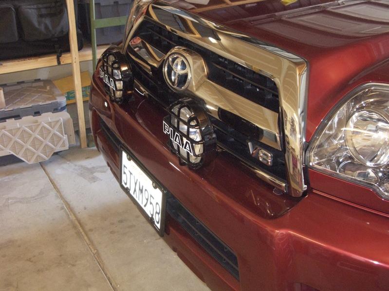

I have been looking into how to mount a set I'm thinking I like the idea of putting 2 Piaa 520's on top of the bumper mounting them below the bumper puts them in harms way but better for the sight of others.

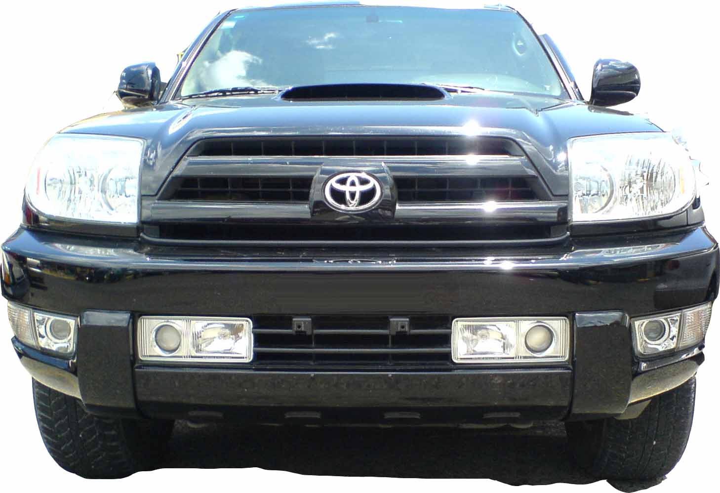

Is it just me or is the last picture MS paint'd? It looks like as if someone added two separate lights on the grill. Not that it's a bad thing, it looks sick! That obviously attracted my attention quickly but as I looked at the rest of the picture, I saw filters being added (white covering the background). I really hope that's a real picture of a 4R with those lights installed on the grill. It looks like it has a pair of factory fog lights & something else (it almost looks like a 3rd gen turn signal light). If anyone has a similar setup like that, take night pictures!!! I want something simple like that!!
Great setup, this is exactly what i'd do.

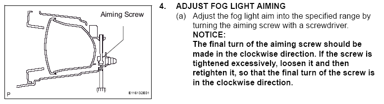

Sorry for the throwback question but how do you adjust/aim the stock fog lights? I crawled under but see no screws or adjustment points. I have one light that points about 4' lower than the other and would like to even them out.
(I got to this thread through a search but nothing else came up directly related to my question)
Thanks
