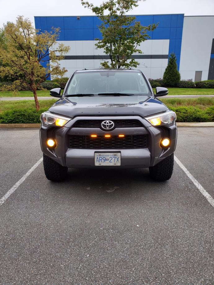

This will allow you to use fog lights anytime. With or without the headlights being on. Also fog lights can be on when highbeams are on as well. Plug and play so no need to splice into any wires.
(In Canada, DRL's are always on when the vehicle is on. No option to turn on and off)
Have been using this kit for a year and a half now.

Which one did you go with I am a little confused by all the models. Is there one that is simple install that doesn’t require any additional switches but allows me to toggle the fog lights on and off with the existing switch? I’m not a big fan of bypassing existing switching and functionality. And I see they also stay on with brights if you want them to, is that correct?
The kit I have requires a switch which is provided. Whenever the switch is ON it will override the normal function of the fogs from the stalk. When the switch is OFF your fogs operate as normal. Only thing is when the kit switch is on, it does not show the icon on your dash until you turn them on from the stalk.
Yes they stay on with high beams - if that is what you mean by 'brights'.
You would have to confirm with the maker as to the details of each kit as it has been a while since I looked into it.

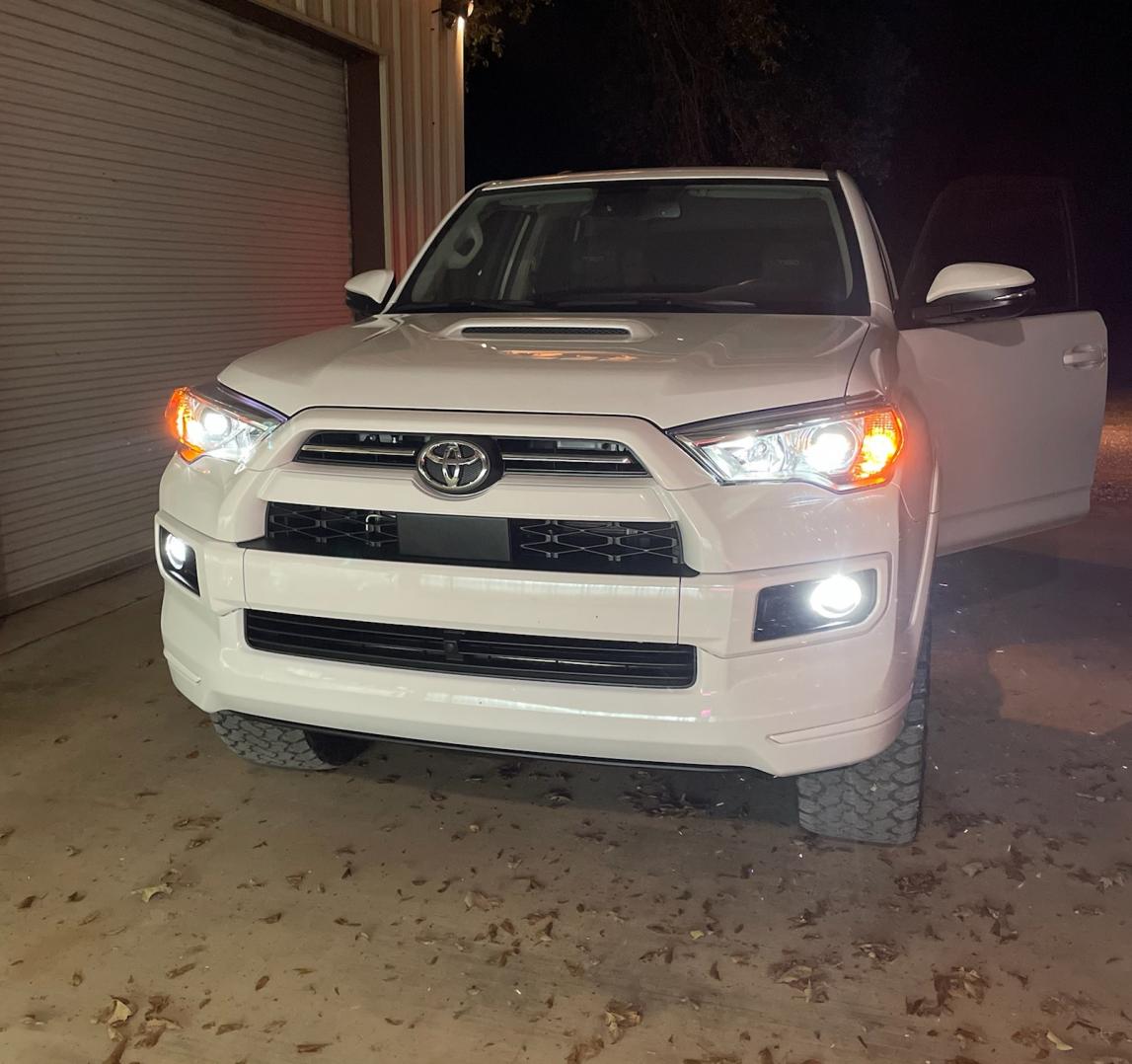

My new 23 TRD Sport with LED headlights and LED upgrade fogs has a button on the left side of the steering wheel that will allow the fogs to work with high beams.
Round switch on the stalk allows fogs to be used on low beams.
Switch on the dash to the left of the steering wheel allows the fogs to work on high beams.
This does not allow the fogs to work on DRL or marker light position though, but i am somewhat confident you can wire it with a relay to trick the ECU to also run the fogs with DRL and markers. I have not looked into rewiring yet, its in the future when i do some floorboard lights and a few other things have the lower dash pulled out.
Here is a pic i just went out and took. This is Low beam, high beam, and fogs. Completely 110% bone stock its brand new i have not wired anything.

I think the button you are referring to is automatic high beam. the fogs should only work with low beams. owners manual I'm sure will say that fog lights can only be used when headlights on in low beam
